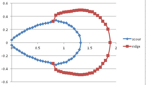

I've exported my CFD result as a dxf file to display it in Autocad, I want to get the XY coordinates of bed changes(I mean the width of the cavity and the bump/dune downstream of the cavity) as can be seen in the attached file. unfortunately, my exported shape is not as a volume, but it is a 3D FACE. I've been trying to solve this problem over the past two weeks. but, i've had no luck to find a way to get xy coordinates.

As you mentioned, I can do this by ID command or lisp programs, but my main problem is that the parts of my deformed geometry are not quite obvious so that It is not easy to recognize the boundary between the deformed part(i mean the boundaries of cavity & bump) and the smooth surface, while I exactly need to extract the coordinates between the two boundaries. clearly, i've been looking for having the width of cavity & bump in plan view. to clarify the issue, I've shown what I mean in the attached picture. about exploding the geometry, unfortunately, it does not work in this case.
I dont know if AutoCAD have a tool to detect the smooth surface of the deformed surface or if there is an autolisp program that can help me.
