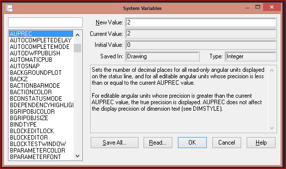

I think it must be something in settings, but I need to measure angles accurately and currently can only measure in whole degrees, I need to 2 decimal places.
Either go to the Units section of Format menu, or set the system variable AUPREC (Angle Unit PRECision) to 2.
There is an interesting distinction between these two approaches, as explained in these screenshots from the SYSVDLG dialog. EIther or both might be invoked, depending on your needs.

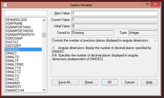

This can also be accessed through the Dimension MODIFY dialog, as shown in the other screenshot.
The variable adjusted in the Dimension Modification dialog, via the dropdown list, would be DIMADEC.
