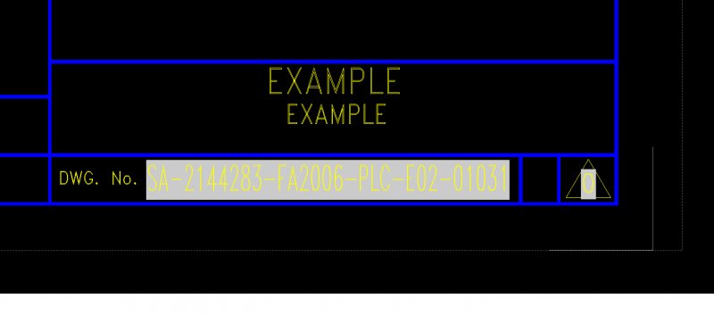

Hello,
I have a lengthy lisp routine that hasn't been updated in years. It is strictly for Custom Field Insertions and I do not remember how to edit it. I created a diesel expression for what I'm trying to do which is simply adding dashes to a filename and removing the last 4 characters for our DWG #'s in the CAD file. I've made a diesel expression included below but it is too long for using MacAttEdit so I'd like to add it to this lisp routine if someone can understand it. Or perhaps if someone knows how to make the Diesel Expression shorter as I am just a novice at this.
Our current file name is (28 characters):
AB12345AB1234ABCA123456789-1
The DWG # is (FIRST 24 characters plus 5 dashes, so 29 characters):
AB-12345-AB1234-ABC-A12-12345
Diesel Expression (long I know):
%<\AcDiesel $(substr,$(getvar,DWGNAME),1,2)-$(substr,$(getvar,DWGNAME),3,5)-$(substr,$(getvar,DWGNAME),8,6)-$(substr,$(getvar,DWGNAME),14,3)-$(substr,$(getvar,DWGNAME),17,3)-$(substr,$(getvar,DWGNAME),20,5)>%
Lisp with custom insertions:

A pic will suffice as it is just a field insertion, pic below. If there is a way to make the diesel expression shorter or "ADD" to the lisp routine it would be helpful. The lisp is lengthy because it has many custom field insertions in it. In the pic below I have an insertion on the DWG no. however the Diesel Expression is too long so I would like t add it to the lisp routine. Also in ths case there are 7 numbers after the first two letters, stead of 5 that I originally posted. We either have 5 or 7 digits after the "SA" characters, the rest is the same. Thank for any help!

That is exactly the reason why we're asking for a sample drawing. On that pic you posted, what is the drawing name to start with?
and this

That way, we could see what other field expressions the title block is referring to within the Custom property

On the attached drawing [ SA2144283FA2006PLCE020103101-1.dwg ], the "DRAWINGNUMBER" tag gets the field value from "ForTitleBlock" Lisp Variable and for "REV" tag its "RevisionFromFilename"
Command: FROMLISPTOTBLOCK
HTH
EDIT: Come to think of it, there's no point in using fields if one is using a lisp code to generate the value :D
HTH
