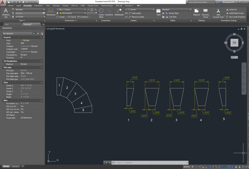

I would like to make a steel frame out of steel tubing. I intend to have large bends in the frame that are acheived by welding segments of angle cut pipe together otherwise known as a lobster back bend.
What I would like to do is design the frame on autocad and to be able to print off templates for each pipe segment which I can use as a stencil to wrap around and mark it out for cutting with an angle grinder because I do not own a band saw.

Is this steel tube or pipe? I ask because it's confusing on technical terms: tube is squared and pipe is round.
Another question: so by "bend" are you meaning you're literally putting your tube/pipe through a roller, achieving a desired radius? Or is this straight lengths of tube/pipe that's segmented and welded at joints that are cut to a specific mitered angle to achieve a desired path?

It is steel pipe and I do not intend to roll it, just weld it together out of segments.

If you want to do segments, you can achieve this easily depending on how accurate you want to be. You can piece out each segment and dimension it from the start/end point on the outside and inside of the pipe. Connect the dots will give you the "angle". I mean, this is "redneck engineered" in the garage kind of stuff, so please understand this is not the proper way to fabricate this kind of stuff. If you're looking for professional union-quality standards I'm not your guy. I tinker with welding and I've done things like this in the past on personal projects and it's good enough for government work. ;)
Image to give an example:
https://imgur.com/a/hhTyckK

Here is a video for doing the development on those

See if this thread can help you. It deals with exactly what you need
