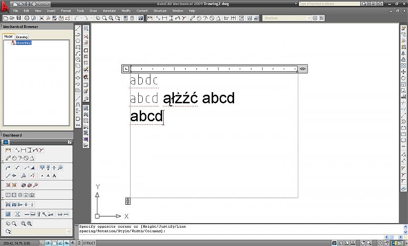

blub Posted January 20, 2009 Author Posted January 20, 2009 Polish SP2 update for 2009... sorry but i forgot to mention that it is autocad 2009 mechanical not the regular one and as i looked there isint a sp for the mechanical 2009 Polish letters you say... I also have a english AutoCAD and use Swedish letters, in most fonts they work, what I type on the keyboard is what's displayed in AutoCAD. So try with a couple of different fonts to find one that works for you. where do you check the keyboard that autocad has found ? and all the text styles didnt work all i get when trying to type polish letter is this "?" Quote
Tiger Posted January 20, 2009 Posted January 20, 2009 ...where do you check the keyboard that autocad has found ? and all the text styles didnt work all i get when trying to type polish letter is this "?" I have no idea where to check what keyboard AutoCAD thinks you have... I found THIS list of Alt+-codes (use the one under the Decimal heading) and bear in mind that it's a link to a blog so it might disappear without a moments notice. You are using MText right? On my machine, if I'm in a font that doesn't support the symbols, it'll switch to something that does. Quote
blub Posted January 20, 2009 Author Posted January 20, 2009 You are using MText right? oo mtext that works perfectly thx eh i dont know why but it dosnt work so good as i thought it will afther typing polish letters that show up only bold then the text afther is bold aswell (look on the image) o i get it now it changes to arial afther typing polish letters Quote
