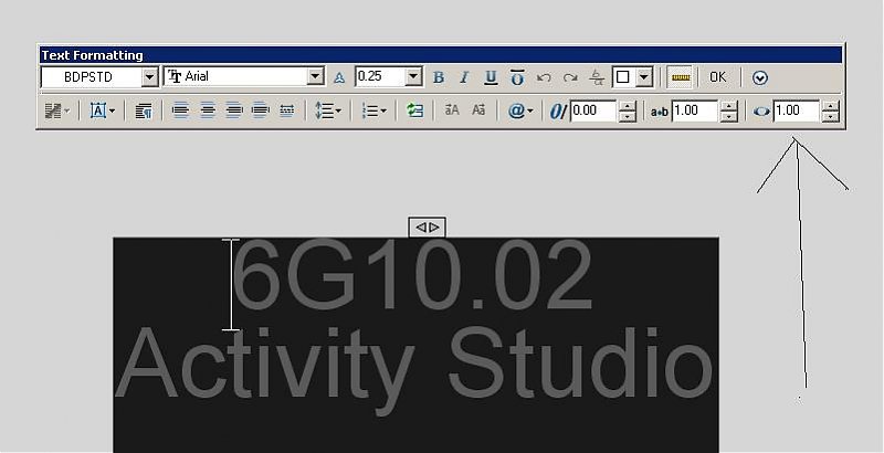

Is it possible to change the text width in multiple Mtext (approx 300) all in one go? I dont fancy going into each one and doing it.

Sorry I don't quite understand what you mean. If I select all the mtext there is no where in properties to change it or are you suggesting I set up a text style with the width set to what I want?
go into STYLE, and have your BDPSTD style current, change the text width to what ever you wish, hit apply, exit dialog, text is new width.
