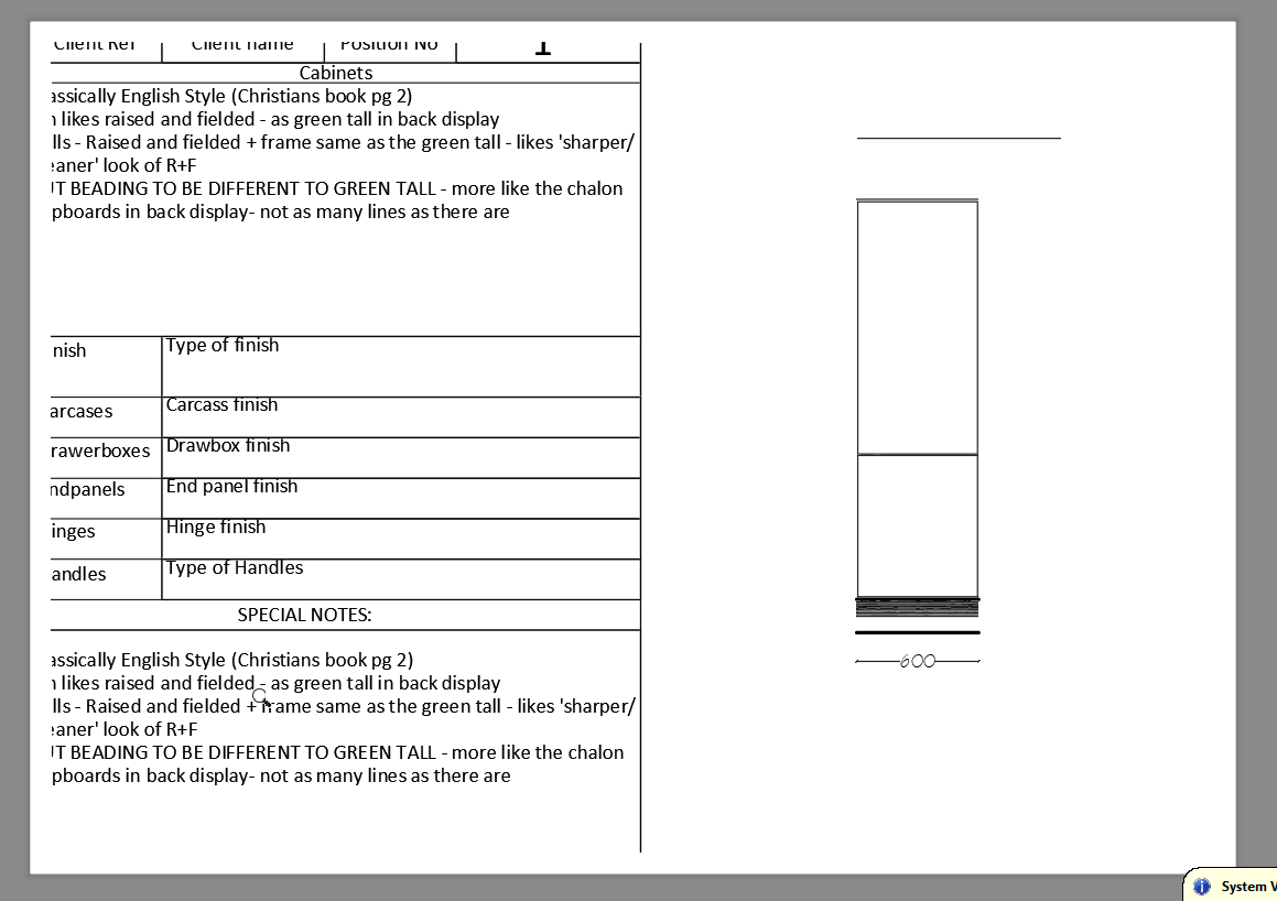

im after a little bit of help on my layout i have a viewport showing a cabinet ( on the right hand side ) i have it set to a 1/1 scale but when i print its short and does not scale correctly when using a ruler to check.
i sure its a setting in the plot screen , i have the plot to scale box ticked so it fits on a piece of a4 - this creates a scale of 1mm = 21.02 units
im stuck as how to get around this

I would hazard a guess that you are drawing in mm units, but you have started on a feet and inches drawing template.
It is so much easier sorting out layouts and viewports when the correct template has been used to start with.
As I tell people, every plot is to a scale. For instance, 1=21.02 is a scale, it's just not a very useful scale.
What most people do is set the paper space to the size of their paper (hence the name). When you add a viewport, you scale it to fit onto that piece of paper, with whatever other bits you need, such as a title block. Then you print at 1:1, which simplifies the plotting process.

To get you out of your present predicament, try changing the plot scale to 1mm = 25.4 drawing units

However, if you type MEASUREMENT at the command line, it returns 0, which suggests that you started with a feet and inches template which would be the cause of your difficulty.

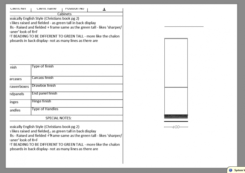

@eldon just tried that the border actual came in about an inch all the way around but i did do 1 mm = 20 units that worked to make the unit the correct size but the grid / block was over the edges of my paper

i also printed out at a scale of 1mm = 25.4 units and got a border of about one inch all the way round, and when I measured the dimensioned length of 600, I measured 24mm. This means that it is printing out on paper at a scale of 1 to 25.
What border are you expecting? What scale are you expecting on the print? Perhaps your border in model space is not quite right. I still reckon your starting template was not metric.
Running the -DWGUNITS command one can see that in this case the drawing units are set to inches as eldon has surmised.
i did the measurement instruction before and it came up as 0 . so eldon was right im using a template set to inchs but using mm ,

Had a look at your dwg and you have a problem no matter what you do you have a title block at A2 size, the mistake you have made is that an A2 cut sheet of paper is exactly 594x420 mm there is no printer that will draw a line at that sheet size exactly on the edge.  You have not taken into account what is known as the hard clip limit, for good printers these days it about 10mm on every side for an A2 sheet.
To print on say an A4 sheet its down around 6mm edge so you need to make your title fit in those clip limits, this is a very common and I guess beginners mistake, so you need say -12 all sides plus say 2mm and it will work for A2, A3, A4 100% every time. ie 594-12*2-2 420-12*2-2
