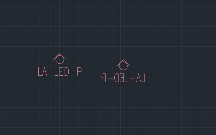

HELLO, I HAVE A QUESTION, I HAVE 2 SAME BLOCK , BLOCK NAME AND ROTATION ANGLE IS SAME, BUT I DON'T KNOW WHY SHOW DISPLAY TEXT IS MIRROR, LIKE TO THIS JPEG ,
ANYONE KNOW HOW CAN SOLVE, THX

Mirrtext -> 0 [ Depending on the current state of the block that is ]
Edited by pBe
You have mirrored the block, a close inspection of some of the entitiy details "Normal" reveals it is mirrored. Just do mirror again.

mirrtext -> 0 not work, any other method can solve this problem??
The normal vector of the block is -1 on z axis. It is somehow mirrored about XY plan.
You can fix it like this

THIS LISP ONE TIME ONLY CAN SELECT ONE BLOCK, HOW TO SELECT ALL BLOCK?

HOW TO ONE TIME SELECT ALL BLOCK TO SOLVE, THX
Nice one stefan played with vla-put-normal worked once then went weird.
Another way to manually correct the problem is to rotate3D 180° about the Y axis.

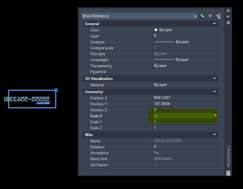

is it possible to provide whole lisp code for reference?
Of course. Just be aware that the image sample in OP can be generated by some different settings, like MIRRTEXT = 1. Those errors are not fixed by my lisp.

thx for your swift reply.
but, when i execute the command "text", he ask me to select the objects, but I can't select any objects.
Like I said, it might be not the same situation.
Select your mirrored block and set the x scale to 1.
