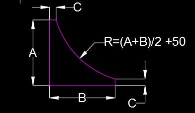

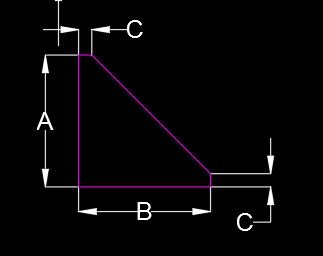

Hello, I’ve just started to learn AutoLisp and made my first code to draw this figure.
The Inputs are A, B and C , but instead of straight line, I’d like this to be an arc with radius (A+B)/2+50.
I can't understand how to use Autocad commands into my AutoLisp code ( for example Autocad command ARC with start end and radius).
Is that too difficult to be done?

The first shape is not that hard to create, but I'm not sure about the one with the arc, is it possible for it to have that radius and be coincident to the ends of the 'C' lines?
(defun C:test ( / a b c p )
  (and
    (progn (initget 6) (setq a (getreal "\nA: ")))
    (progn (initget 6) (setq b (getreal "\nB: ")))
    (progn (initget 6) (setq c (getreal "\nC: ")))
    (setq p (getpoint "\nSpecify insertion point: "))
    (entmakex
      (append
        '( (0 . "LWPOLYLINE") (100 . "AcDbEntity") (100 . "AcDbPolyline") (90 . 5) (70 . 1) (43 . 0.0) (38 . 0.0) (39 . 0.0) )
        (list (cons 10 (mapcar '+ p (list b 0))))
        '( (40 . 0.0) (41 . 0.0) (42 . 0.0) (91 . 0) )
        (list (cons 10 (mapcar '+ p (list b c))))
        (list (cons 10 (mapcar '+ p (list c a))))
        (list (cons 10 (mapcar '+ p (list 0 a))))
        (list (cons 10 (mapcar '+ p '(0.0 0.0))))
        '( (40 . 0.0) (41 . 0.0) (42 . 0.0) (91 . 0) (210 0.0 0.0 1.0) )
      ); list
    ); entmakex
  ); and

I tried to have this use very simple autolisp calls
Find the chord distance, angle and mid point
With known radius and half chord length, find the distance from chord mid point to center
Calculate the center point.
(defun c:foo (/ ac ab cd ch ca cm ra)
  (initget 7)
  (setq a (getdist "\nA:   "))
  (initget 7)
  (setq b (getdist "\nB:   "))
  (initget 7)
  (setq c (getdist "\nC:   "))
  (redraw)
  (command "_.ZOOM" "_W" (list -2 -2) (list (+ a 2) (+ b 2)))
  (setq ac (list a c)
        bc (list c b)
        cd (distance ac bc)
        ch (* cd 0.5)
        ca (angle ac bc)
        cm (mapcar '(lambda (a b) (* (+ a b) 0.5)) ac bc)
        ra (+ (/ (+ a b) 2.0) 50))
  (grdraw '(0 0) (list a 0) 1)
  (grdraw '(0 0) (list 0 b) 2)
  (grdraw (list a 0) ac 3)
  (grdraw (list 0 b) bc 3)
  (grdraw ac bc 4)
  (grdraw cm (polar cm (- ca (* pi 0.5)) cd) 5)
  (setq cl (sqrt (- (*  ra ra) (* ch ch))))
  (setq ce (polar cm (- ca (* pi 0.5)) cl))
  (command "_.ARC" "_c" ce bc ac)
  (prin1 (entget (entlast)))
  (prin1))
