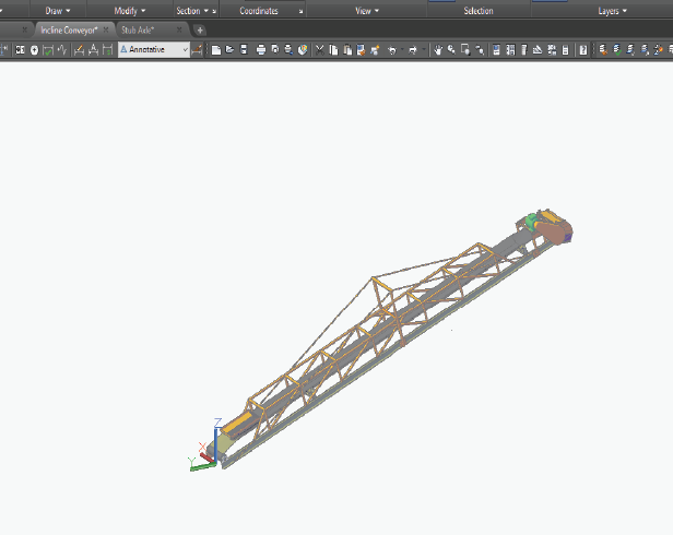

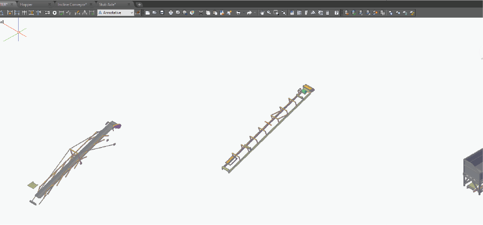

BjK Posted September 7, 2018 Posted September 7, 2018 New to this but i'll give it a go. The attached screenshots show a conveyor I am working on. As shown in the base drawing versus the how it appears in the 'MASTER' drawing once attached File Untitled - 1 is as displayed in original File Untitled 2 is as displayed once attached Need help. Thanks Quote

BjK Posted September 8, 2018 Author Posted September 8, 2018 All layers visable and thawed. Images are in model space - appears the same in paperspace It seems to happen when i move objects in the inserted dwg, to align to 0,0,0. (I always do this prior to attachment to master drawing). The inserted drawing looks correct on the screen but when attached as xref it goes haywire. Happens also when inserted as a block but not as often The only way i have corrected it sofar is to identify misaligned objects - go to source drawing - move those objects - then move then back - save drawing - then reload drawing in master document. VERY time consuming I have tried regen and purge in both files but no luck Any help appreciated - thanks Quote
Cad64 Posted September 8, 2018 Posted September 8, 2018 5 minutes ago, BjK said: The only way i have corrected it sofar is to identify misaligned objects - go to source drawing - move those objects - then move then back What do you mean by "misaligned objects"? Can you post the dwg so we can take a look? It sounds like the model was not built correctly. Quote
BjK Posted September 9, 2018 Author Posted September 9, 2018 Misaligned as per image 2 compared to image 1 Quote
ReMark Posted September 9, 2018 Posted September 9, 2018 Please attach a copy of the problematic drawing to your next post. If the file size is too large upload it to a file sharing website such as DropBox and post a link to the file here. Quote
Cad64 Posted September 9, 2018 Posted September 9, 2018 7 hours ago, BjK said: Misaligned as per image 2 compared to image 1 It's difficult to tell what's happening in the images, but it appears that maybe the model was created while looking at it from one viewing angle only. This is not a good way to work in 3D. You need to constantly orbit around and look at the model from different angles. If you build the model while looking at it from one side only, it's possible that some parts of the model could be constructed far away from other parts of the model. That would explain why you have to go back to the source drawing and move some objects back to their proper location on the model. Quote
