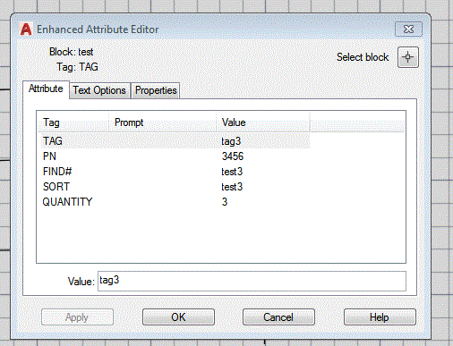

data extraction for command line.
so i am trying to create an entire system so that i can engineer an electronic schematic with about 3 button presses. most of it is done however i have run into a wall on the last part witch is exporting a bill of materials. the issue is that i need to essentially run the data extraction wizard from the command line, witch as far as i am aware (PLEASE CORRECT ME IF I'M WRONG) can not be done. so i have set to the task of recreating the wizard for the command line, more or less that is. but now i need help, i have attached a copy of my code (largely borrowed from various people). it originaly was to print the block name and handle, i have no need for those so i have been attempting to remove them but now when i run the script it creates a sheet like this:

TAG is the name of a tag that i want included in the list, i am not sure why it is printing like that, and N/a is where the handle used to go but i cant seem to get rid of it printing it... any help on this would be great.

that looks like it might work, but I might need help integrating it into the existing program. specifically, how do I add the object selection.. I'm not very familiar with the SS functions.

none of them are constants, the tag names are: "TAG" "PN" "FIND" "SORT" "QUANTITY" I was able to figure out one way of doing this on my own but i feel like there is a much better way. so i look forward to seeing how you would limit it to only those five attributes. also i am looking forward to seeing how you write this info to excel. what i had made no sense to me lol.

I have noted that one of the block tags in the example drawing you sent is named "FIND#" not "FIND", which is correct?
