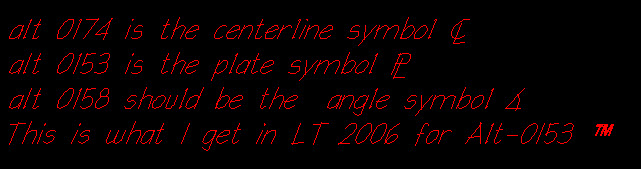

I like the handletter look of ARCHS.SHX and use it in Autocad LT 2002. I do structural detailing ( although I am an Engineer and only dabble in CAD ) and use the special symbols for Centerline, Plate, and Angle. I have no problem using the symbols in LT2002 and use the Alt-0174, Alt-0153, and Alt-0158 respectively to letter drawings with mtext. I use LT 2002 even though we have ACLT 2006 available because I am used to the menus and look and feel.
When I try to use the special symbols in LT 2006 in mtext, the Alt-0174 works for the centerline but the Alt-0153 comes back as a TM (trademark?) and the Alt-0158 comes out as a Z with a v on top of it instead of the Plate Symbol and Angle Symbol.
The odd thing is that I can create the text in LT 2002 and then open the DWG in LT 2006 and it looks and prints correctly, but when I try to use it in Mtext I get the wrong symbols.
I have the same search paths in both versions since the LT 2006 was an upgrade from LT 2002 and used the same settings. :( Has anyone else run into this problem? I did try a search.

The ARCHS.SHX is the only hand letter font that I know of that use the special symbols I need. I'll try to attach an image of what they look like if I can figure out how to do it. I think I was succesful.

I thought the Alt-XXXX was just the way you specified an ASCII character that was not on the keyboard. The correct symbol may be somewhere in the table and I don't know how to display a map of symbols that correspond to the 4 digit ASCII code. I tried to run CHARMAP but the ARCHS font is not on the list. The ARCHCHAR.DWG file that comes with the fonts shows the available special characters.
I just tried out DTEXT and put in %%153 and I get the correct symbol for Plate in ACLT 2006, but when I use Mtext and put in %%153 and hit OK, I get the literal %%153 on the drawing. So now I wonder why Mtext does not behave like Dtext?
With a little experimenting, I opened an Mtext box and started trying ALT+nnn with the Archs font in the box. If a character exists in Archs, it is displayed. If the character is undefined, the font changes to Arial and I have to reselect Archs as the font.

I am not a power user of AutoCAD, I just know enough to put lines and text inside a border, so you are probably right. I have been sucessful in using the SHX fonts in dimensioning where I can stack fractions and in MTEXT in ACLT 2002 where I can call out angle and plate sizes like PL 3/8 x 8 1/4 x 1'-6 3/16 (50 ksi) and have the plate symbol show up and the fractions stack. I was just wondering why it works in 2002 and not in 2006 versions of AutoCAD LT.
I guess my work around is to use Dtext to put in the symbol for plate then use Mtext to put in the rest of the text. :(
