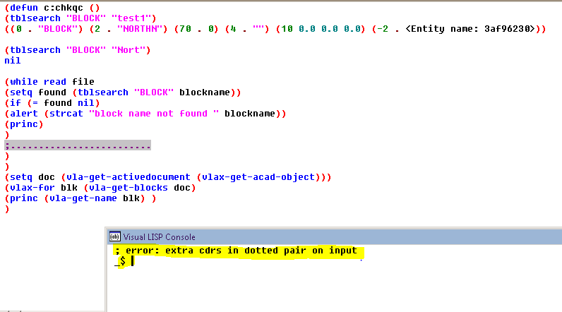

hi Bigal,
                 Thanks for looking on this post, its bit confusing for me to edit the lisp as i am new to this,
i have attached the error screen shot, please check it.
i have a 3 blocks named test1,test2 & test3,
i just need to find this blocks using lisp & tell that "all blocks are available"
if one block is missing, it should mentioned its name like " test2 is missing"
Thanks
(defun c:foo (/ l)
  (setq l '("test1" "test2" "test3"))
  (foreach a l (or (tblobjname "block" a) (alert (strcat a " DOES NOT EXIST!"))))
Edited by ronjonp
changed and to or
Thank you both ( ronjonp & tharwat), it worked like a charm :)
