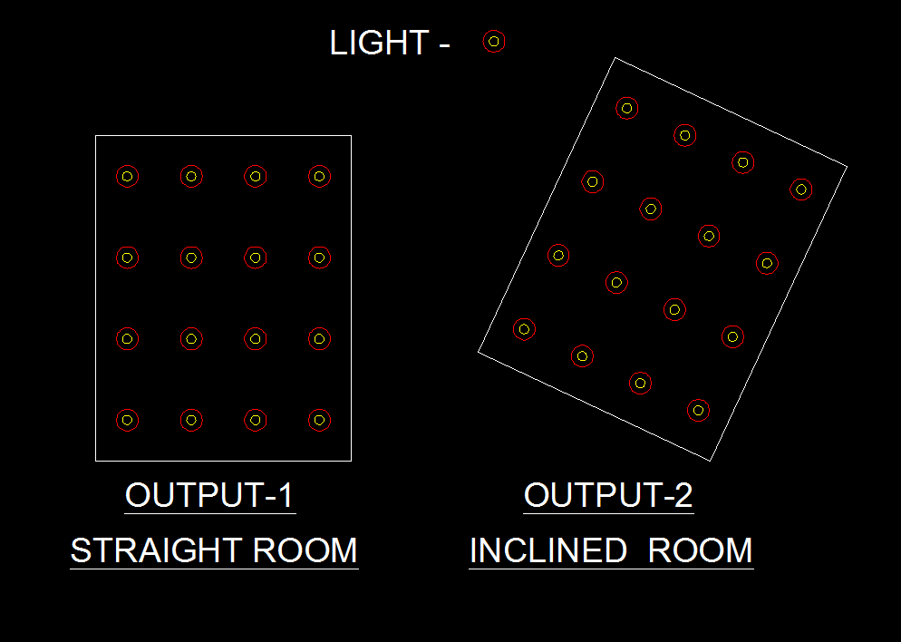

Dear all,
I got a lisp code that can generate required no of rows and columns inside a two corners of a rectangle. But I need a change in that it should ask for selection for rectangle irrespective of  the rectangle is in straight or in inclination position

Selection of a rectangle instead of asking for two corners.dwg

Maybe a simple answer try using UCS this will set the angle then run the lisp.
6 hours ago, danglar said:
You can try to draw rectangle not in straight or in inclination position (Lee Mak solution)
and then to distribute lighting poles according to your routine
(see attachment)
Draw a rectangle at any angle.lsp
Pretty sure this is not my code...
