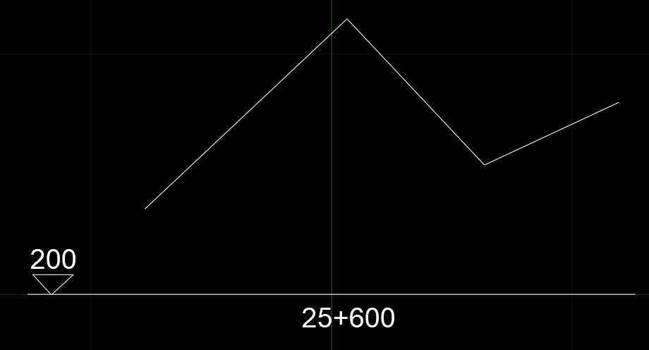

Hi guys,
I would need a lisp for exporting to csv or txt file 2d polyline vertices from a cross section based on the picks:
1. pick the chainage
2. pick the 0.0 offset line
3. pick the reference level line
4. pick the reference level elevation text
5. pick the polyline for exporting vertices
The lisp would calculate offsets and elevations comparing to picked 0.0 offset line and given reference level.
the data exported to csv/txt file would have structure like this:
chainage
offset on the left;elevation
offset on the right;elevation
for example:
25+500
-5.0;212.22
-3.0;200.50
1.1;205.69
4.6;202.37
Does anybody have a code which could be used for developing such workflow?

As a lisp answer the simplest is to read the cross section text its normally two rows so pretty easy, pick chainage text, select row, select row, all done.
The problem is I have pure DWG drawing, those are not cross sections from "active" road corridor model so cannot use it in Civil3D or other software to extrude reports.
As for your second advice it is not a solution cause in the rows you got usually TOP surface levels, and what I need is to export ANY polyline on the cross section (like specific pavement layers etc. which are of course lower than TOP surface), that's the intention here.
I found is a lisp which exports polyline to txt file, but it I have no idea how to set a Local UCS and export the vertices in a reference to new level (Local UCS) - the export always goes in a reference to Wold UCS...
not sure  what  is your cross section view
(defun c:mu (/ p y ) ; move ucs
  (princ "\nCurrent UCS origin : ")
  (while (not (and (princ (getvar 'ucsorg))(setq p (getpoint "\nSpecify base point at datum level line & zero offset line: "))
		   (setq y (getreal "\nEnter known reference level elevation (datum) : "))
		   (vl-cmdf "_.UCS" "MOVE" (mapcar '- p (list 0.0 y 0.0)))
   (princ (strcat "\nX=0.00 Y="(rtos y 2 2) ) )
example you have a level datum line = 100.00, you pick at cross section X&Y axis as base, i.e:  X should be 0.0 , Y= level elevation 100.00
Command: mu
Current UCS origin : (-61.6464 134.407 0.0)
Specific base point at datum level line & zero offset line :  user picked
Enter known reference level elevation (datum) : 100
X=0.00 Y=100.00
Then you can check the polyline  coordinates by command ID or LIST, (The X value -ve LHS & +ve RHS , Y=elevation level )
or export the  coordinates to EXCEL using LISP etc..

Thanks for your reply, I am getting closer
I modified the code:
1. I added the option to pick the reference level from text string. This will be used to set local UCS (it works:)
2. I added the option to pick the cross-section chainage (text string)
3. What is missing is looping the whole operation for multiple sections and exporting the set of data to external file like below
sample file structure:
25+500 (from text string - chainage)
-5.0;212.22
-3.0;200.50
1.1;205.69
4.6;202.37
25+600
-2.0;213.22
-3.0;201.50
5.1;205.69
6.6;202.37
25+700
-4.0;202.22
-2.0;220.50
5.1;212.69
8.6;212.37
I put some comments in the code
Could you help with this?

A sample cross-section:
-5.0;212.22
-3.0;200.50
1.1;205.69
4.6;202.37
25+600
-2.0;213.22
-3.0;201.50
5.1;205.69
6.6;202.37
