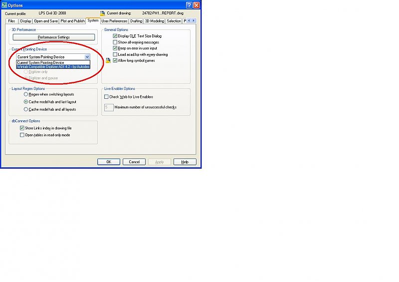

JONTHEPOPE Posted January 21, 2009 Posted January 21, 2009 I would like to calabrate a tablet please help when i type cal i get this any ideas ? >> Expression: Quote
mdbdesign Posted January 21, 2009 Posted January 21, 2009 _cal is for calculator, not for calibrate tablet First go to: Tools menu: Tablet Command line: tablet Enter an option [ON/OFF/CAL/CFG]: Quote
JONTHEPOPE Posted January 21, 2009 Author Posted January 21, 2009 I get this reply WHEN USING MY POINTING DEVICE ???? Your pointing device cannot be used as a tablet. Quote
lpseifert Posted January 21, 2009 Posted January 21, 2009 Check in Options > System for something like this... Quote

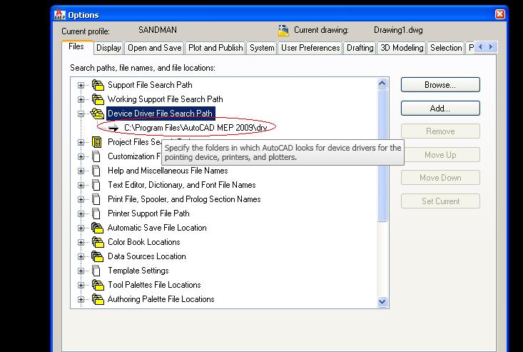

davedelay Posted June 26, 2013 Posted June 26, 2013 I am currently setting up the same digitizer for the third time. The second time was the best with nice absolute coordinate recognition. This time I can't remember what magic voodoo I did to make it work. I keep getting an error message when I tell autocad to recognize "wintab by autodesk" But I have a calcomp super3 using TW 10.9.24 driver. Quote
ReMark Posted June 26, 2013 Posted June 26, 2013 You're attempting this using AutoCAD 2012 and what OS? Quote
davedelay Posted June 26, 2013 Posted June 26, 2013 You're attempting this using AutoCAD 2012 and what OS? I have windows 7 - 64 bit Quote
ReMark Posted June 26, 2013 Posted June 26, 2013 The last OS you got it to work with was what? XP? And was that 64-bit too or 32-bit? Quote
davedelay Posted June 26, 2013 Posted June 26, 2013 The last good configuration was to the same machine with same Win7 -64bit. Right now I have to crop off some of the usable 30"x36" of tablet space to have the aspect ratio match my monitor/autocad window. Along with a scaled window so that it's 1:1, kinda hokey. I bummed that I didn't keep notes on how I got it work correctly last time. Quote
