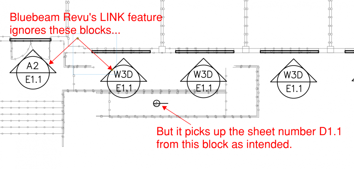

Bill Tillman Posted November 29, 2018 Author Posted November 29, 2018 (edited) Okay, it's all coming back to me now. What I did a year ago was to PUBLISH and set the PDF Options to print to individual files instead of a single PDF file. I also had to select to not to append the filename to the new files. Then I used the Combine feature in Bluebeam Revu to put all the files in a single PDF file. This allowed me to check the option to use the filename as the page label. That took care of the problem with the [1]. [2], etc... text in the page labels. Now the remaining issue is why does BB not pickup the text I want linked on some of the blocks. I use several different blocks for detail bubbles and one of them gets picked up fine. The other one BB ignores. I tested and confirmed this. BB is only picking up a certain block and the other one I use similarly it's ignoring. Both blocks are in the same layer, and are almost identical in that they have a circle with the detail number in the top half and the sheet number in the bottom half. Oh well, I didn't have any plans for tonight except watching a football game with my grandson so I'll end up hacking this to it's conclusion as well. Edited November 29, 2018 by Bill Tillman Quote
