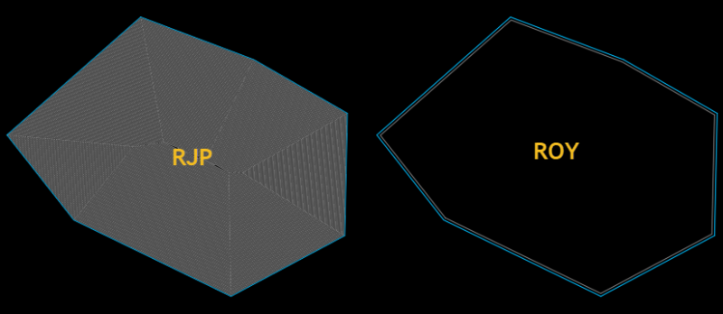

I have several different closed polylines that i have to offset
inside with the same distance (query which distance) so long until this is no longer possible.
Can someone please help me to automate this?
Example file in the appendix.
Thank you for your help.

need a check for "Cannot offset that object." I am sure there is some sort of distance parameter longest side etc needs more thought.
Try:

Another for fun:

Hi Guys!
Thank you for taking the time
to support my post.
Both programs are great.
Exactly what I need.
Thx.
Jürgen

@ronjonp: If the polyline is not convex the Offset method can create more than one new entity.
@Roy_043 Definitely :). We should also check that the current layer is not locked or it will chuck a wobbly. Code updated above to put items on current layer.
@ronjonp
AFAIK the source entity's layer should not be locked. When you assign a new layer to entities it doesn't matter if that layer is locked.

Ah yes, of course. The first new entity becomes the source for the next step and therefore cannot be put on a locked layer.
This version should fix that:
