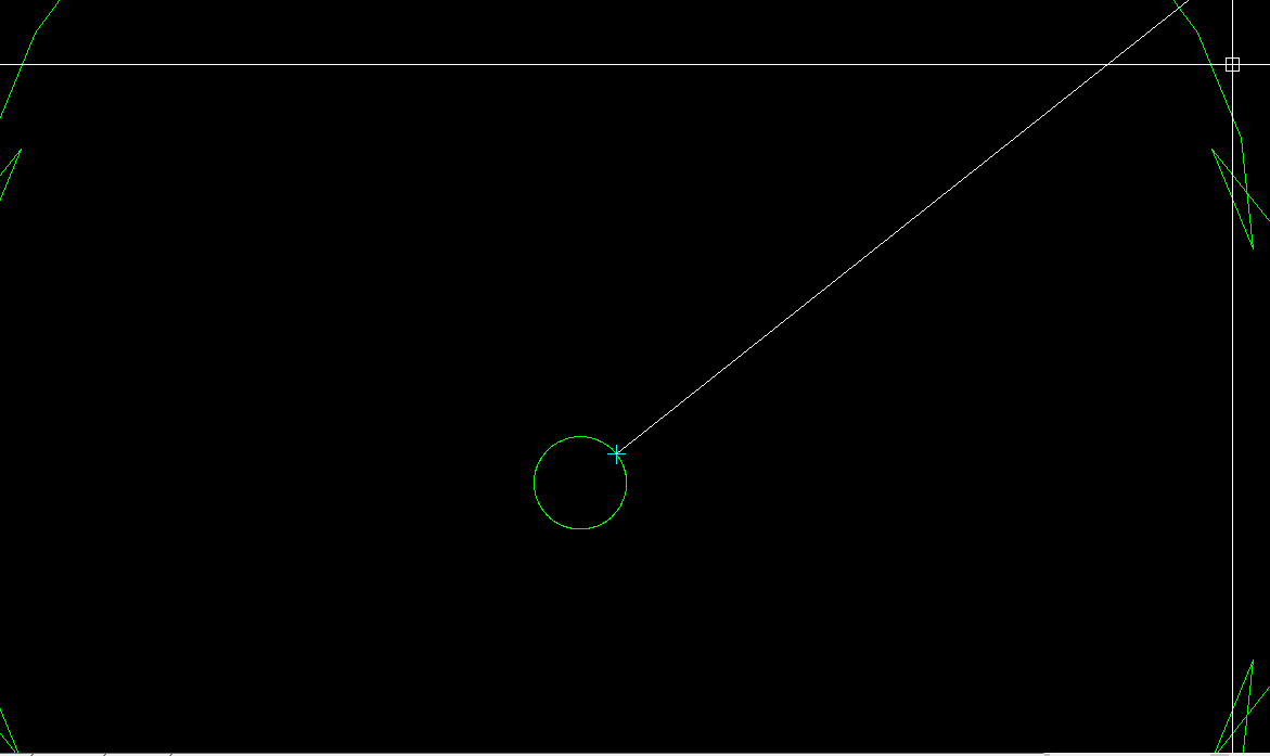

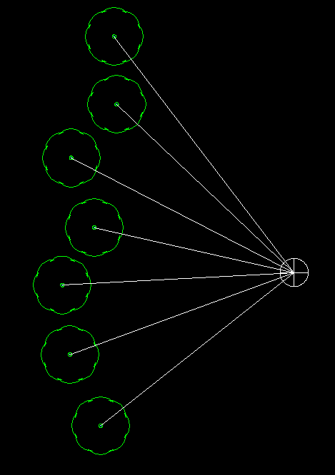

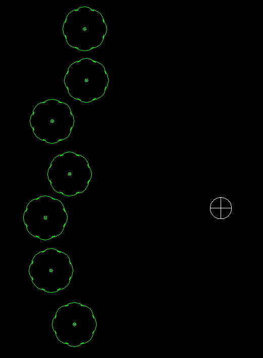

Essentially on a topo survey I am reflectorlessly laser shooting trees from a survey station, on the drawing my nodes are then central to the trunk and I need to move them to the edge of the trunk circle. So I am looking to have multiple objects at once move a set distance directly away from a specific point.
I have attached images showing my current process, but needless to say it can be very tedious when there are a lot of objects. I draw a line from the station point to the center of each trunk/node, then move the trunk along the line until the edge of the trunk circle intersects the line.

Agree with Eldon I watch our guys they do a side shot to get distance then you shoot centre. Quick way is a dynamic block with spread and trunk as independant variables, this way you can do a centroid to instrument distance move very easy.

Without knowing any bole details (girth or radius/diameter) and whether this is a block,  two blocks (bole and spread) or a circle and polyline; it's not possible to code a lisp to do this. :cry:
If you supply these details it a simple operation. :celebrate:
