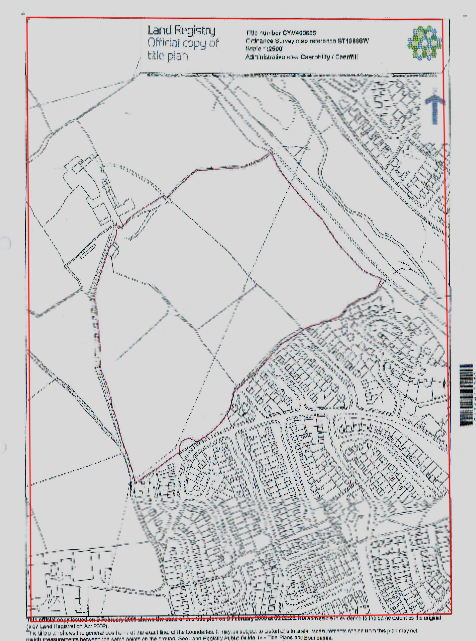

I have a raster PDF that i need to distort to fit into a trapezium shape. Does anyone have any ideas how i could do this?
A before and after sketch might help, turning the pdf into a block will let you scale x or y independantly (rotating the pdf first before creating a block,  would let you create a parallelogram).
But a trapezoid? Is this an image pdf or geometric
Not sure how clear this is but I'm trying to get the frame on the pdf to fit to the redline (which is rectangular). I have tried creating a block with the pdf at an angle but the distortion in the pdf is in not regular. Looking at it again it's not actually trapezium but a scalene quadrilateral.

It's a photocopy of a photocopy which has then been scanned. I appreciate the plan is no longer accurate but the client wants me to overlay it onto a site layout to see if he has any issues. I have a digital CAD model of part of the housing housing area which I intend to use locate the plan once I've managed to get as square as possible. I know I can download a new pdf from the Land Registry (assuming the land has been registered) but i get asked  for this on just about every site and every time I'm given a sh*ty photocopy or scan to work with. There must be a way of mapping the pdf to an area and manipulating it by moving the edges or intersections. Basically I want to paste it onto a stretch armstrong and pull it around.

If you compare Ordnance Survey data with a modern topographic survey, usually there are no common points, and the best one can achieve is a best fit, which lines up some of the  points. I use Align, using two points. One can then see gross errors when comparing.

Given the comments above, I would also doubt any change would be valuable, other than visually pleasing, but what you want to do is probably more suited to an image editing program like photoshop, or gimp a free program that also has various tools for transforming objects, you will want to look at things like "skew" and "shear"
