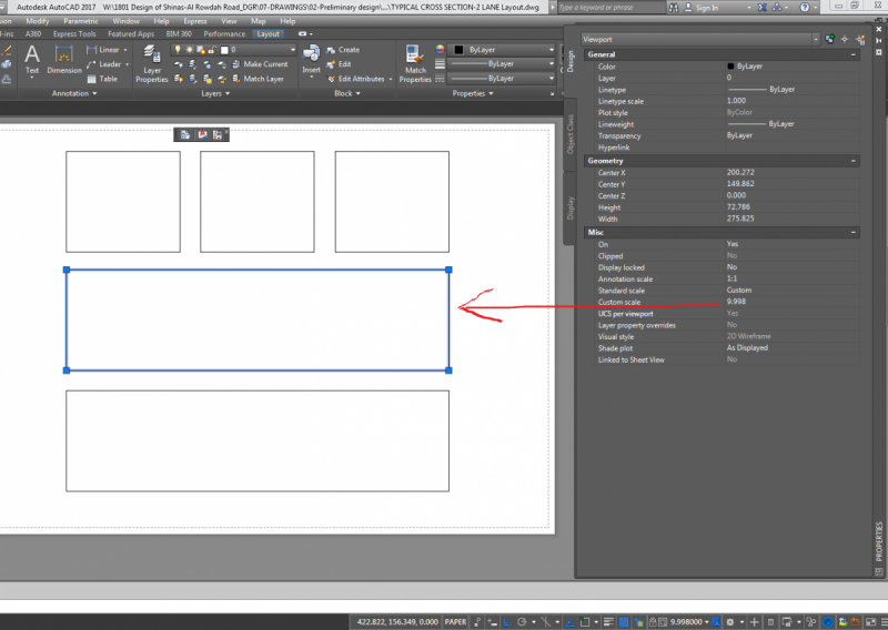

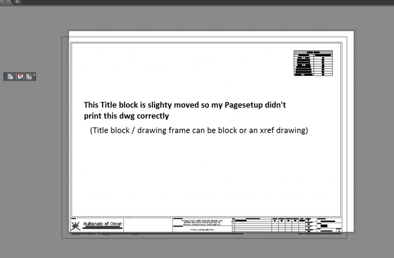

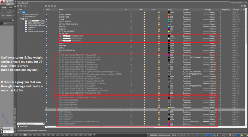

sivapathasunderam
I have to work on a new project which done by others, I what to find out the errors and fix it
Example etc,
1.) If the dwg frame (Title block) xref base point position is not same for all dwgs I can't use a page setup file to all dwgs.
2.) Viewport scale errors (someone kept open the viewports, not locked) due to that error happen
3.) base point of the dwg
4.) Xref layers properties setting should be same for all dwgs
This will be a most useful for many people

maratovich
Why do you think this is a mistake? Maybe it should be so.
paragraph. 1 - this does not affect printing.
paragraph. 2 - agree.
paragraph. 3 - this does not affect printing.
paragraph. 4 - you can not change layers, it can be changed only inside the external link.
