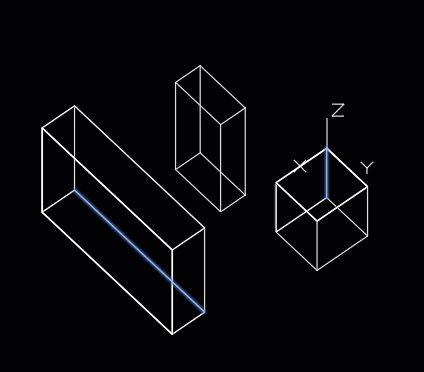

PrimeTimeAction Posted January 29, 2019 Posted January 29, 2019 Is there an easy way to make hatches at the top face of 3D solid. I have a drawing that contains steel platform areas as 3D solids with various thickness, The solids are at different levels. I want to have hatching at the top face (to show grating). What iam am doing now is exploding all solids to get lines/arcs, then switch to front/side view and delete the "thickness" lines. Afrer that i switch to top view and make polylines for all the platform. Then i create hacthes and then move it to the correct level. But all this takes alot of time. Is there any way to expedite it? Quote

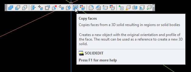

ronjonp Posted January 30, 2019 Posted January 30, 2019 20 hours ago, PrimeTimeAction said: I want to have hatching at the top face (to show grating). What iam am doing now is exploding all solids to get lines/arcs, then switch to front/side view and delete the "thickness" lines. Afrer that i switch to top view and make polylines for all the platform. Then i create hacthes and then move it to the correct level. But all this takes alot of time. Is there any way to expedite it? What version of AutoCAD do you have? I'm on 2019 and there is a command to copy faces which would drastically improve your workflow. Quote
PrimeTimeAction Posted January 30, 2019 Author Posted January 30, 2019 Iam on Autocad 2016. With copyfaces i will have to select one solid at a time. I have nearly 100s of small island of 3d solid. Its easier to explode and delete the bottom and side surface then use PE command to get polyline. Quote

ronjonp Posted January 30, 2019 Posted January 30, 2019 (edited) This simple code seems to work fairly well ( not much error checking ). (defun c:foo (/ a e p) (while (setq p (getpoint "\nPick a point in a face: ")) (setq a (entlast)) (command "_.Solidedit" "_Face" "_Copy" p "" '(0 0 0) '(0 0 0) "" "") (cond ((not (eq a (setq e (entlast)))) (redraw e 3) (command "_.ucs" "_Ob" pause) (command "_.bhatch" "_S" e "" "") ) ) ) (princ) ) Edited January 30, 2019 by ronjonp Quote
ronjonp Posted January 30, 2019 Posted January 30, 2019 (edited) This one removes the second pick .. will still STB if the point is not within a face though. (defun c:foo (/ a b e p) ;; RJP » 2019-01-30 (while (setq p (getpoint "\nPick a point in a face: ")) (setq a (entlast)) (vl-cmdf "_.Solidedit" "_Face" "_Copy" p "" '(0 0 0) '(0 0 0) "" "") (cond ((eq a (setq e (entlast))) (print "Boundary not created..")) ((/= "REGION" (cdr (assoc 0 (entget e)))) (entdel e) "Boundary created not valid..") ((setq b (vlax-invoke (vlax-ename->vla-object e) 'explode)) (command "_.ucs" "_OB" (vlax-vla-object->ename (car b))) (mapcar 'vla-delete b) (command "_.bhatch" "_S" e "" "") (entdel e) ) ) ) (princ) ) Edited January 30, 2019 by ronjonp Quote
