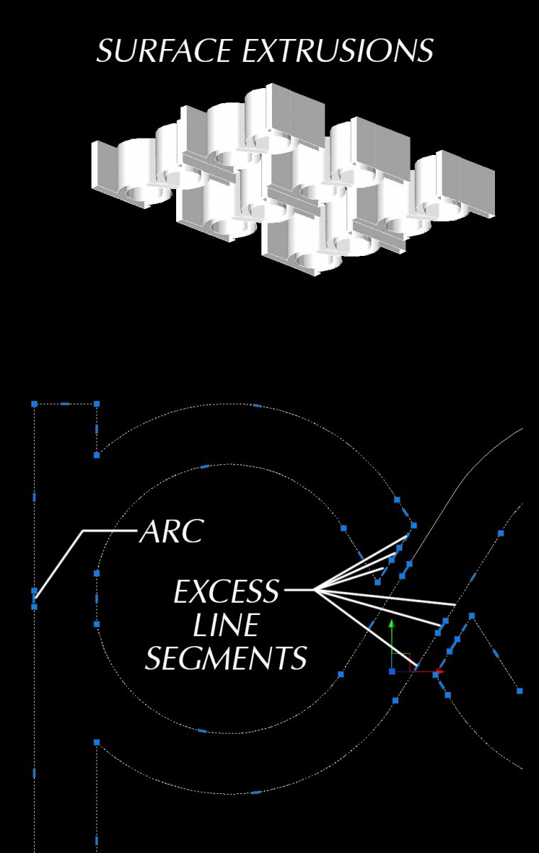

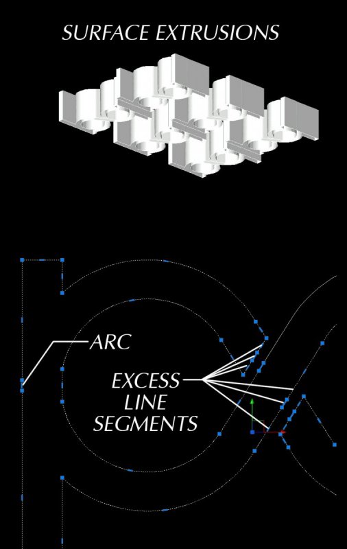

Cad64 Posted February 5, 2019 Posted February 5, 2019 I created a new layer, moved the big solid object to that layer and then froze the layer. That exposed a bunch of surface extrusions. So I deleted all the extrusions and found that your polylines are not all joined together, so I ran PEDIT and joined all the polylines. Then I discovered that your polyline geometry was not very good. There were arcs where there should have been straight line segments and also multiple line segments where there should have been one continuous line, so I cleaned up all the polylines and now you can Presspull with no problems. I have attached my file so you can compare it to your file. Choc PD logos-Revised.dwg Quote
