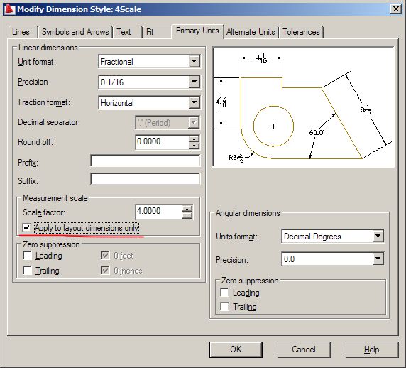

SEANT Posted January 23, 2009 Posted January 23, 2009 In an effort to allow a Dimstyle to be used for both Modelspace and PaperSpace, AutoCAD uses a negative (-) flag to restrict dimension scaling to PaperSpace only. The flag is applied to the DIMLFAC system variable via settings below. Quote

SEANT Posted January 23, 2009 Posted January 23, 2009 Yes, the DIMLFAC methodology is definitely a legacy procedure. I think both annotative dimstyles and associated dims with dimassoc = 2 are the more modern method of dealing with various dimension scales. Quote
