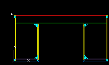

BIGAL
Is this what your after ?
Share this post
Link to post

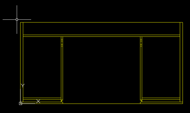

Jord_91
My original drawing was this one.
In fact, I would like to have the result of the Flatshot drawing without using the flatshot command as it's not possible to put it in a script or a lisp.
I came out with this script sort of instead of only using the Flatten function trhat let me a drawing of over 1Mo I have a drawing of 105Ko what is really interesting but still not as acurate of the flashot command with a perfect 2D drawing and a lowet size of 39Ko.
_open *file* _filedia 0 _-view _top _-layer off QUINCAILLERIE-BLANC off QUINCAILLERIE-SN off QUINCAILLERIE-CHR  -Layer N 2D  _ai_selall  _AUDIT _yes _ai_selall 2FLAT 2flat _Flatten no _AUDIT _yes _change _all  _prop _layer 2D _co yellow  _ai_selall _-overkill _done _PURGE _all * n -purge r * n _AUDIT _yes _ai_selall _-overkill _done _PURGE _all * n _-purge r * n _AUDIT _yes _ai_selall _-overkill _done _PURGE _all * n _-purge r * n _-VIEW _TOP _filedia 1
Here is the 2Flat lisp I use in this script 2flat.lsp

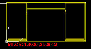

 What's left for me is to ad a dot in each 4 corner of the drawing and to make a script to add the name of the dwg file in text attribute in the drawing (x,y,z) 0,-6,0...
It may sound complicated but at the end the result should look like this. So I need to take my 3D and make a 2D of the top view of it. Clear sort it's the Lighter possible (it's why I put it on only one layer called 2D. Finally I need to add the text attribute that coppy the name of the file in it.
