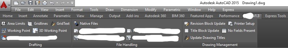

So how I manage rolling out new lisps or blocks to the org is to have a ribbon tab with buttons for each command/block.
One thing I'd like to be able to do is add an update button so that whenever there's a new update to the ribbon tab, it would remove the previous iteration and load the new one with the new stuff (I'd set this up every time, but that would be easier than going to each person and resetting up their ACAD).
I am trying to figure out how to do this with lisp (really, the only language I know for CAD customization right now). I found a previous thread about it but I am having issues figuring out how to make it work for me.
SS1 shows how the current ribbon tab is setup and SS2 is how it shows up when I do something similar to the code I used in the thread I found previously.
Any and all insights into "menucmd" and how to do this is appreciated.
