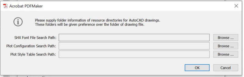

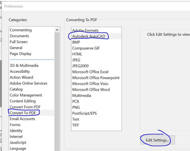

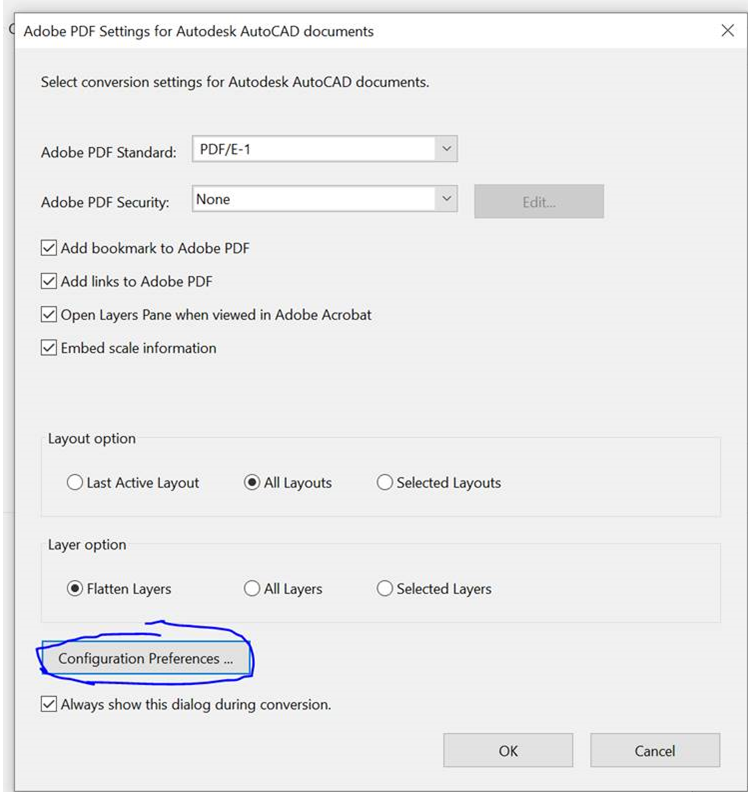

ILoveMadoka Posted November 3, 2020 Author Share Posted November 3, 2020 I have made *some* progress on this front and am having pretty good success creating searchable PDF files from Autocad.. In Acrobat Pro DC Options/Preferences When I map these paths I am finding 90% success in Autocad 2020 creating Searchable PDF Files. Hope it can help someone else. Quote Link to comment Share on other sites More sharing options...
