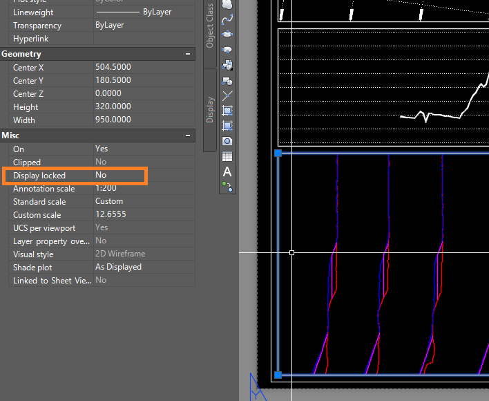

Is it possible that I can't find the unlock viewport button?
i clicked outside the frame, inside, checked the properties, the ribbon.. nothing....
it was available the other day when I unlocked the panel below.... mysteries.
when I click the viewport below I get different properties and I see the display locked/non locked option, but for the center panel there is no such option...
Anyone?

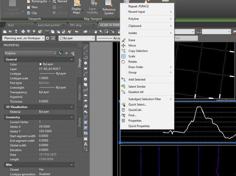

It looks like that is a clipped viewport, that is, it has a polyline frame. The properties show that they belong to a polyline. You may need to select both and then unselect the polyline, or open the entity list and select the viewport, which will give you access to the viewport's properties.

Or click PAPER on the status bar to go into the viewport and toggle the Lock icon on the status bar.
A clipped viewport should display as a "Viewport" in the Properties panel, not a Polyline, and you should have the option to lock/unlock it. My guess is that you have a polyline drawn on top of the viewport.
