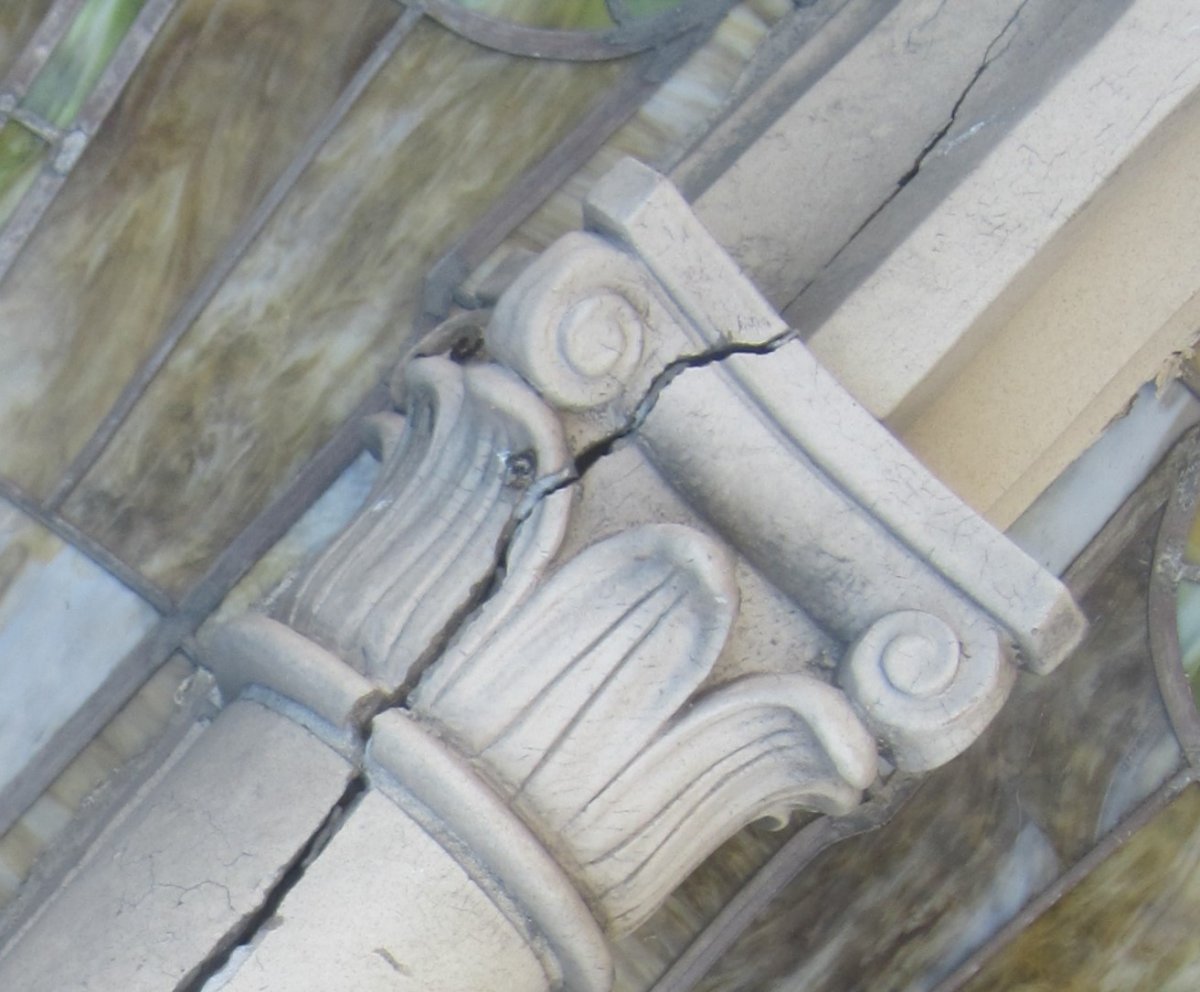

Hi All,
What would be the best software to model up the attached masonry unit?

Here's an older one for Form Z but it should apply to just about ANY 3D program that can do similar commands (revolve, loft, sweep, bend, etc..).
ftp://ftp.formz.com/pub/formz/PDF_files/tutorials/version_8/column.pdf
I don't think Form Z Free (missing a few tools) or SketchUp could do it without a lot of extra work. AutoCAD might be able to do it. I am sure a subdivision modeler like Max, Maya or even Blender could do it. Fusion 360 might be able to do it. Moi 3D and Rhino would work well as well.
