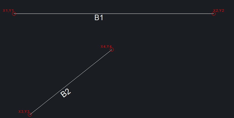

bills Posted April 20, 2019 Share Posted April 20, 2019 (edited) Hi All I am looking for a lisp program using which i can export to excel all the text (or selected text) and nearest line coordinate to that text having angle of inclination varies by +/- 10degree to text angle. Can anyone help me out. Thanks in advance. This will simply my task to a great extent. Edited April 26, 2019 by bills Quote Link to comment Share on other sites More sharing options...

bills Posted April 24, 2019 Author Share Posted April 24, 2019 My requirement is explained in attached images. When i select text in cad, it should detect its nearest line whose angle is similar as text rotation and export the details in csv file. Hope it clarifies. Quote Link to comment Share on other sites More sharing options...

bills Posted April 25, 2019 Author Share Posted April 25, 2019 Generally my drawing units are mm hence the maximum distance of line from text could be restricted to 2000 units and yes i want only 1 result for each text. If there is no line near to text then it should report an error message like "No Line detected" Quote Link to comment Share on other sites More sharing options...

dlanorh Posted April 26, 2019 Share Posted April 26, 2019 (edited) On 24/04/2019 at 06:28, bills said: My requirement is explained in attached images. When i select text in cad, it should detect its nearest line whose angle is similar as text rotation and export the details in csv file. Hope it clarifies. The excel in this image doesn't match up with this presumably "header" line of code (setq data (list (list "text" "length" "x head" "y head" "x point 2" "y point 2" "x tail" "y tail"))) You're explanation mentions text entities and lines, yet you are attempting to select lwpolyline and polylines. LWPolylines and Polylines can have multiple segments and in the case of a Polyline entity be curved and or have an elevation. Perhaps a better explanation of your requirements are needed, including whether the user needs to select the text and lines or all texts and lines can be selected automatically. Edited April 26, 2019 by dlanorh Quote Link to comment Share on other sites More sharing options...
BIGAL Posted April 27, 2019 Share Posted April 27, 2019 Like dlanorh its easy to do a little search around the text object and find something. The smaller the search area the better. using the text height is one way to get the search area. Quote Link to comment Share on other sites More sharing options...
