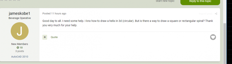

Good day to all. I need some help. I kno how to draw a helix in 3d (circular). But is there a way to draw a square or rectangular spiral? Thank you very much for your help.
Yes you need a 3d path a 3dpline you would need to write a program to work out the x,yz of the points maybe use excel ?
What you have asked for is a stair hand rail.
Not clear on what you want.  Would sweeping a square or rectangle along a helix meet your requirements?    If not, could you clarify?

I think you are interested in a 3D helix and not a spiral.
thanks for the reply guys and sorry for my vague question. i found out how to do it by using the 3d poly . what i'm trying to do is make a pattern similar to spiral but the pattern is rectangular whereas in spiral it is circular. and 3d poly solve my problem.
A square spring! I use individual lines (in a square) then alter the Z value of the individual ends of the lines in the properties palette, once you have the 4 lines touching end to end (except the start/end points of course) then the "join" command will create a 3Dpolyline for you, then you can use the copy command to stack up the spring, again using the "join" command when it is tall enough. I use this technique to create 3D printer tool paths so it is often a more complicated outline than a square, but it removes the problem of the printer head crossing over existing printed lines, dragging the object free from the print bed (a common problem for 3D prints).
In my case, I use a fraction of a millimeter height difference between line ends, the advantage is that you can select individual lines rather than trying to get at the correct vertex and after one circuit all you then need do is copy-paste using the start and end points.

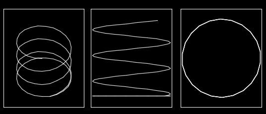

It should be easy using a pline just ask what is rise required and how many turns then just recreate using the vertice of the plines.Obviously a lisp or steven your expertise with excel. Just thinking about the shape to be sqaure to start of 3dpoly. Tested using polygon 22 sided etc.

i did a take a pline shape and turn it square to the rising line and extrude as an extra but with no responses have kept it.
