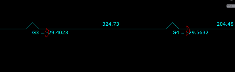

Thanks Emmanuel Delay
But I run lisp, coordinate is not Dirgree Minute Second
Run lisp
Negative value coordinate
I want
Thank you very much.
Edited by iSupporter
Dear,   Emmanuel Delay.
Lisp run don't exactly with file attacht.
Please, view again help me.
Thank you.
Hel3.dwg
I rewrote it a little

(defun c:PTA ( / ss pl lst pts pt1 x y turn_size vertices)
  ;; settings, feel free to change these values
  (setq text_height 8.0)
  (setq text_offset 16.0)  ;; for the angles
  (setq text_offset2 6.0)  ;; for the distance
  (setq turn_size 15.0)
  (setq ss (ssget ":S" '((0 . "LWPOLYLINE,POLYLINE"))))
  (setq pt0 (osnap (getpoint "\nSelect the trunk <osnap on the base of the trunk>: \n") "_end"))
  (setq pt1 (getpoint "\nStart point of the horizontal polyline: "))
  (setq x (nth 0 pt1))
  (setq y (nth 1 pt1))
  (setq pl (vlax-ename->vla-object (ssname ss 0)))
  (setq lst (vlax-get pl 'coordinates))             ;; extract the vertices
  (if (= "AcDb2dPolyline" (vla-get-ObjectName pl))  ;; polyline or 2D polyline ?
    (setq pts (3d-coord->pt-lstrjp lst))
	  (setq pts (2d-coord->pt-lst lst))
  (if (< (distance pt0 (last pts)) (distance pt0 (nth 0 pts)) )  ;; user picks which side we start
    (setq pts (reverse pts))
  (setq pts (skip_overkill pts))
  (setq vertices (list (list x y)))
  (setq g 0)
  (foreach itm (distance_and_angles pts)
    (if (not (zero (nth 0 itm))) (progn
      (if (< (nth 0 itm) 0)
          (setq vertices (append vertices (list
            (list (setq x (+ x turn_size)) (+ y turn_size) )
            (list (setq x (+ x turn_size)) y )
          ;; write turn caption
          (setq g (+ g 1))
          (Text
            (list (- x (* turn_size 2))  (- y text_offset ))
            text_height
            (strcat "G" (itoa g) " = " (nth 1 itm) )
            (list (setq x (+ x turn_size)) (- y turn_size) )
          (setq g (+ g 1))
          (Text
            (list (- x (* turn_size 2))  (+ y text_offset ))
            text_height
      ;; take back the size of the turn
      (setq x (- x (* turn_size 2)))
      (list (setq x (+ x (nth 2 itm))) y )
    (Text
      (list (- x (/ (nth 2 itm) 2))  (+ y text_offset2 ))
      text_height
      (rtos (nth 2 itm) 2 2)
  (Polyline vertices)

Thank Emmanuel Delay very much.
You take some time to help me change layers.
Good luck for Emmanuel Delay!
Now it uses your layers
But I test file attachment is wrong angle. Because, reverse angle G3, G4.
Please view file attacht.
reverse angle.dwg
