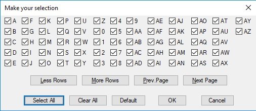

; RLX 20 may 2019 - Multi-tokkie dialog
; reason for writing is upcoming server change and have to scan server for drawings with xref and remove xref path.
; Each plant area has folder (like '0000' '0100' etc.) Each plant folder has a few dozen subfolders. Some subfolders
; will contain drawings with xrefs for certain and some will certainly not (like loops)
; Ultimate goal was to be able to put as much of (selectable) information in one dialog as possible.
; To be able to do this dialog can be resized. Either with the buttons or with mnemonic keys.
; You can use L & M for Less or More rows (min 5 rows , max 25) and N for next page or P for previous page if all
; the information is too big to fit in one screen.
; I have set width for dialog to 120 (max-dialog-width) but adjust as you see fit.
; hope examples c:t1 & c:t2 are self explaining
; max-num-of-rows / start-column / result-list -> global vars needed because dialog will be recreated if resized

(defun c:t1 ( / fol lst dflt max-num-of-rows start-column result-list)
  (setq dflt '("E" "FGA" "G" "GE" "GX" "HV" "S" "TC" "U"))
  (if (and (setq fol (getfolder "Targetfolder"))
           (vl-consp (setq lst (vl-remove-if '(lambda (x)(member x '("." ".."))) (vl-directory-files fol nil -1)))))
    (progn (create_multi_tokkie_dialog lst dflt "Select subfolders") (alert (show-result result-list))))
(defun c:t2 ( / lst dflt max-num-of-rows start-column result-list)
  ; just some test data
  (setq lst '("A" "B" "C" "D" "E" "F" "G" "H" "I" "J" "K" "L" "M" "N" "O" "P" "Q" "R" "S" "T" "U" "V" "W" "X" "Y" "Z"
              "0" "1" "2" "3" "4" "5" "6" "7" "8" "9" "AA" "AB" "AC" "AD" "AE" "AF" "AG" "AH" "AI" "AJ" "AK" "AL" "AM"
              "AN" "AO" "AP" "AQ" "AR" "AS" "AT" "AU" "AV" "AW" "AX" "AY" "AZ"))
  (setq dflt '("A" "B" "AA" "AB" "5" "6"))
  (create_multi_tokkie_dialog lst dflt "Make your selection")
