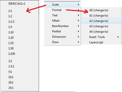

Raggi_Thor Posted January 26, 2009 Posted January 26, 2009 After doing this manually a few times for the trainig, setting limits, dimscale, textsize, hpscale, grid, snap etc, I think your teacher should give you a pulldown menu like this: Quote
