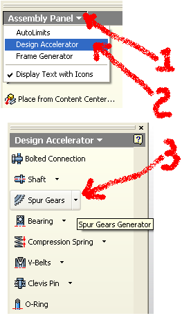

shift1313 Posted January 26, 2009 Posted January 26, 2009 ojh, as jd mentioned design accelerator. There will be some dynamic inputs for your gear, things you will need to know about it. Do you have a gear in front of you? If you go into the design accelerator look for a helical gear. Quote
ojh Posted January 26, 2009 Author Posted January 26, 2009 design accelerator? sounds like another brand new thing for me to play and learn with, i do the design stuff at home on another computor. Thanks much guys, will check back tomorrow with yea or nay. oj Quote
shift1313 Posted January 26, 2009 Posted January 26, 2009 design accelerator or content center is just a library of parts built in. You can create many things like bolts, nuts, roll pins(which you will need for that gear ). I have inventor 09 on my home computer but i only have 11 on the one im sitting at now so i cant tell you exactly how to get to it. If it doesnt show up go to the tools menu, add-ins and make sure you have it there. Quote
JD Mather Posted January 26, 2009 Posted January 26, 2009 You must be in an iam file to use the DAcc. Quote

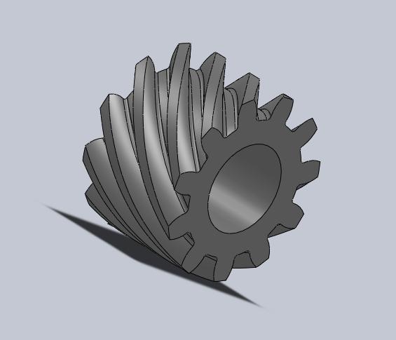

shift1313 Posted January 28, 2009 Posted January 28, 2009 im not sure what you mean by multiple teeth. you are looking for something like this right? Quote
ojh Posted January 28, 2009 Author Posted January 28, 2009 Way wrong Shift! The helix goes the other way! Just being a smartass, you are too good. That is about perfect. Did you do that with one plane, 1 plane per two teeth or one tooth per plane and multiple planes. Quote
shift1313 Posted January 29, 2009 Posted January 29, 2009 (hangs his head in shame), i actually didnt do that in inventor. I used solidworks. Are you drawing the gear or are you loading it from the content center? For some reason my Inventor wont open at the moment but if I were to draw it, i would draw the gear shape in one plane, copy that to another, and loft between them. Im not sure if there is a twist option but you can use a 3d sketch and draw a spline from one edge on your bottom plane to the other edge you want the "tooth" to go to on your top plane and use this as a guide. can you post a picture of what happened to yours? Quote

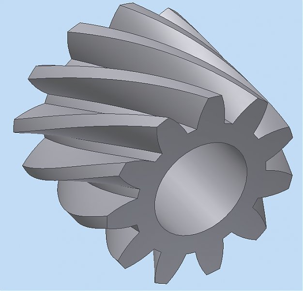

JD Mather Posted January 29, 2009 Posted January 29, 2009 Way wrong Shift! The helix goes the other way! Here is one done in Inventor using the DAcc - about 60 seconds of work - another 5 seconds to change the helix direction. Quote

JD Mather Posted January 29, 2009 Posted January 29, 2009 I will go looking again and will report back in a few days. Thanks, oj F1 Also it sounds like you haven't gone through Help>Learning Tools>Tutorials as there is a Tutorial on Gears as well as several other Design Accelerator components. Quote
