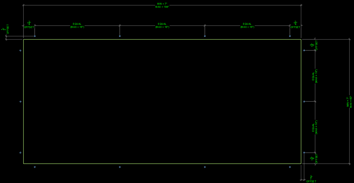

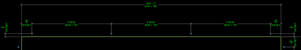

Hello all, I need some help in creating a dynamic block to stretch with an array. I cannot seem to find the correct combination for the block. I have worked on this with many iterations, but mine are not working at all. I started with an example of one already created, but my manipulations to the example do not work either. So in this image attached is what I am looking for.
This should be a single line array.
The object is a 3/16" diam circle, begin at y=1/2", x=1.75" from insert point. The end array object will be y=1/2", y=-1.75" from the stretch point end.
Intermediate array objects should divide equally along the line with a max spacing = 16"
It would be helpful if the stretch point could be polar stretch to allow for rotation when stretching and a flip feature along the x-axis.
The min/max dimension is not necessary, but would be helpful to transition to a single diam circle centered on the span when less than 7".
(The rectangle pictured is for layout purposes)
I hope this is not too much to ask for help with this block, but I have exhausted my brain's ability to figure this out.

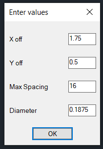

You would just pick two points this gets distance and you have rules like end offset. The auto dimension would be based on pick direction so know which way is outside. Top is L-R bot R-L and so on.  For vertical X & Y would be reversed.
Multi GETVALS.lsp
repeat object along line.lsp

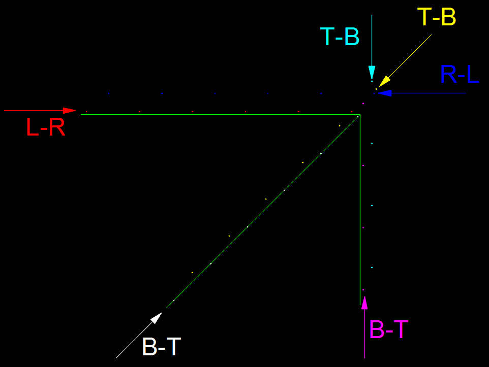

BIGAL - Thank you for this. But it only works for the L-R direction for me. See image below for example. I tried reversing the numbers for vertical, but you can see what happened in the image. All selection points were at the end of the lines drawn, L-R, R-L, T-B, B-T, but the placement of the objects were not setting correctly.
Also, I need something that will handle angled placement as well. Not sure a lisp is going to be practical if I have to enter the differing numbers every time I have to change directions. Seems like a Dynamic Block would eliminate the data entry.
That was the 1st version and found an error in the code I have updated the code and it works for any angle. Just think of L-R etc this dictates the side the circles are drawn on.

Just tried the updated lisp and it works perfectly. Thank you. I can make it work for those that have a full version of CAD.
It does not need to be dimensioned.
