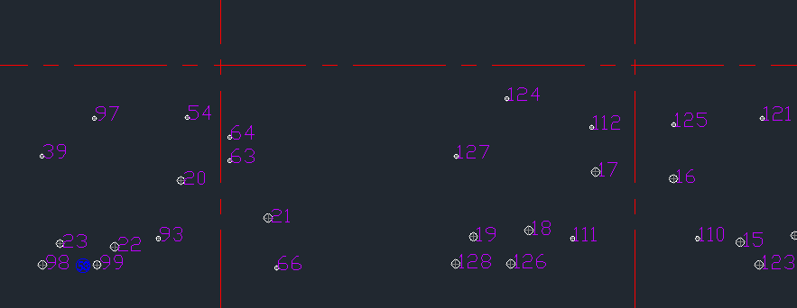

Hello Everybody,
I have a coring drawing have coring number for each core. The problem is that these core numbers are NOT in a sequence (as shown in screenshot below). Is there a suitable method to scroll through each core number in some order i.e. ascending or descending order e.g. core number 7 highlights or shows or anything else visual after core number 8 based on some key combination. Any solution will be helpful.

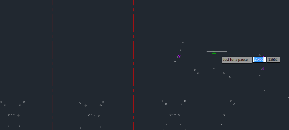

Okay instead of above i found one short-cut to pause at each core before the number is added to the coring. Actually i wanted to check various factors for each cores e.g. if the core is not duplicate, the numbering pattern (no pattern detected which is sad) and connection to other layers (not shown). Below is what i got and currently its helping me for my drawing.
Is this more or less what you want?
Test it on my DWG.
It searches all blocks called "CORING", which have an attribute called "ID".
Obviously this needs to be adapted to fit your DWG.
Will you please upload a sample?  Or just tell me the blockname and tag of the ID, if you are using blocks with an attribute

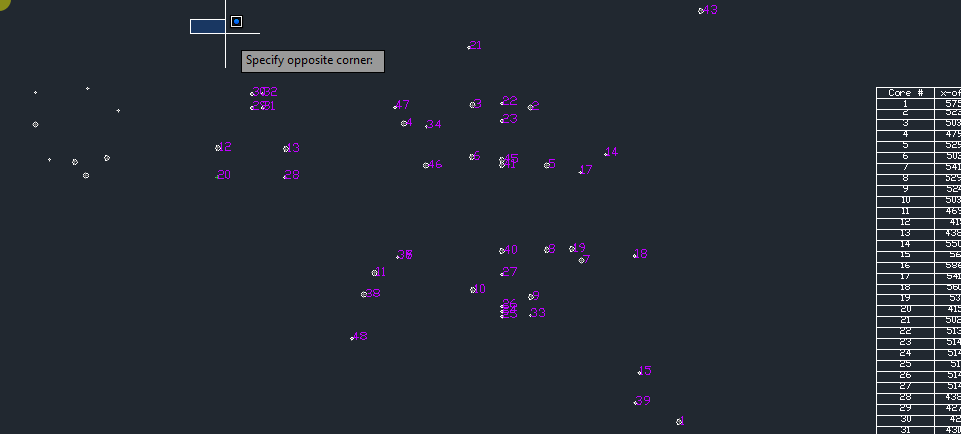

I have attached the file here. It's part of my same problem where i needed to number the cores and then get their x and y coordinates. Fortunately this was excellently solved by Mr. Emmanuel. Now the issue is I have another layer of core numbering (original core numbering done MANUALLY) which needs to be co-related with the auto-generated numbers. I hope the file really helps to understand the situation. Solution given above by Emmanuel is really what i am looking for but needs some fine tuning.
2nd floor.dwg
All my cores (auto-generated) are on the layer "Cores" and all are simple circle (not blocks).
Again thankful to all for the support. I have to repeat this tedious process for over 22 other drawings so want to perfect it on one and then re-use on the others.
Happy with this?
I expect your text objects all on layer "0" and color 200 (purple).  As long as you keep it this way, and don't draw any other text objects on layer "0" and color 200, it should work
Feel free to adapt this zoom level
  (setq zoomlevel 100)  ;; feel free to adapt.
I see that there are two sets of numbers (130 on top, 118 on the bottom part), so I'll let you select the objects first (don't worry about selecting other objects, they get filtered out)
Command LTC
EDIT: Oh yes, using this routine I can see that you're missing number 47 and 113 on the bottom part

As usual many thanks Mr. Emmanuel. This worked like a charm. I am also having a look at lee-mac library which is excellent for numbering. Now the last but not least part (if possible) as i have meeting tomorrow with consultant and he MAY ask is that why the numbering is so RANDOM i.e. numbering starts just anywhere in my selection of cores and then just continues purely randomly. Is there any way to make it bit more regular (like starting from bottom left and continuing in some logical fashion) or there is no way around?
Below is amazing gif showing the working of above code and its just perfect. 😍
