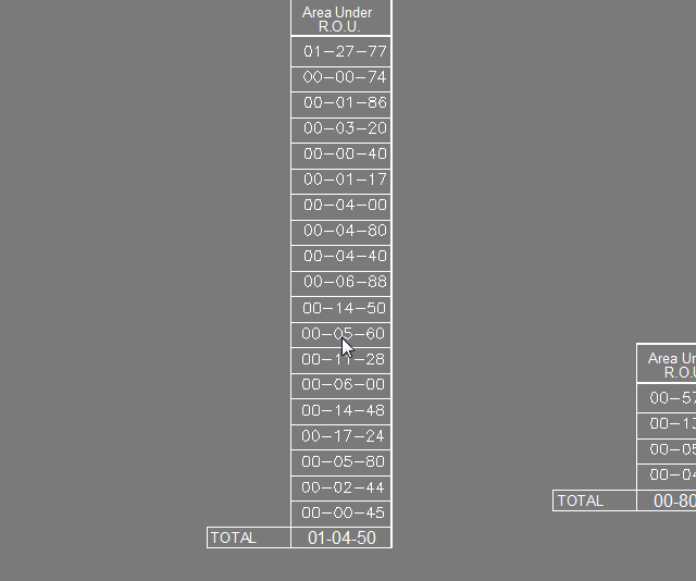

Hello Everyone,
I have to sum value in different formats. ex.  00-01-00
                                                                         +    00-01-00
                                                                Total      00-02-00
Thank you in advance

What you can do is parse the string so break it into 3 bits make a list ("00" "01" " 00") then sum like a column, (nth 0 (nth 1 (nth 2. Lee-mac has a parse.lsp normally used for csv files but yiu can change the delimeter to "-"
Try out this, be a little bit careful when picking text.

Try:

1 hour ago, Roy_043 said:
Try:
    Thank you both for answering, I am sorry that I was a little unable to explain, but Roy_043 Lisp works correctly.

Nice idea looking for non number added to code above any character but still 3 columns.
Edited by BIGAL
Bigal is right. It shows the value of only in three character, I've attached another test2 drawing and you can understand d it better.
Thank you Bigal
Test2.dwg
Edited by sanju2323
missing attachment
I made this one yesterday but never posted it because Bigal had beaten me to it and cant beat Roy's elegant code either but untested on your last example , here it is anyway...

Revised code:

Rlx,
    Thank you so much for the code
     This code is work fine, but there is a small problem in this code. It only sum the object appearing in the screen.
Edited by sanju2323
11 minutes ago, sanju2323 said:
Rlx,
if by this you mean you have to make a selection for each column of texts you are right because if you want to be able to do the entire drawing with one click this would be a complete other ballgame ...
Rlx,
  Please see the attached gif file.
Roy_043,
            Thank you so much your code perfectly work i am so happy. :)
ah I see what you mean and I know the 'problem' , when I was making the code I was thinkin', oh , don't forget to reset the text-list each loop... but that's when Bigal posted his code and I thought , oh darn ... no use to go on... And since Roy's elegant code is working no use for me to update anymore. Nice code Roy!
ps routine is fine , your way of selecting isn't , you are selecting things double because of osnap.
Edited by rlx
rlx,
I did not know that this would be possible, but all of you contributed a bit, your code was great for the loop, but the Roy_043 code gives the exact answer, rather gave me a much better code than i expected, Thank you all for giving your precious time and participating in this forum.
Its the sort of challenge that is interesting looks simple then comes request 2. hence why we all had a go.
