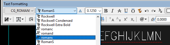

What I have to do is double click inside a single cell, highlight the text and manually change the font via the Text Formatting dialog dropdown
Just picking inside the cell and changing the font via the Text Formatting dialog does not work.
I HAVE to highlight the text in order to change the font.

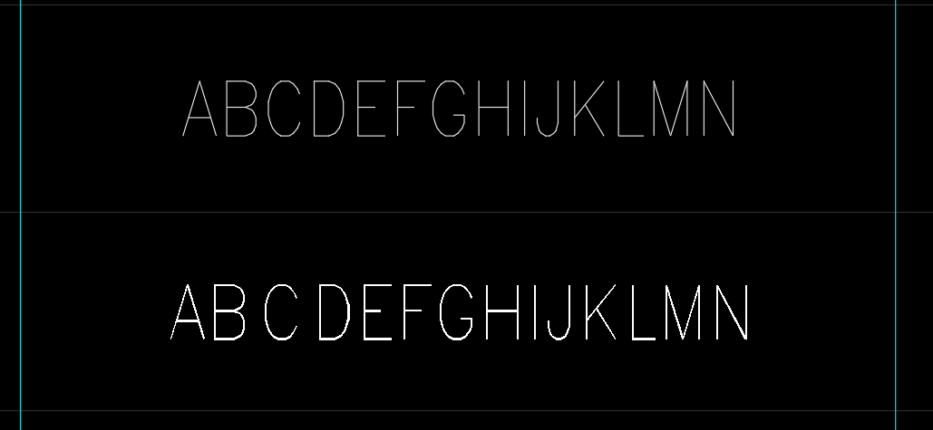

You can definitely tell the difference in the two fonts. SHX on the top
