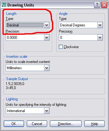

go into Format > Units and change your units there to meters or millimeters as well.
Or just type in units on the command bar. :thumbsup:

If you haven't got too far yet - restart the drawing in metric mode. If you have gotten a fair way into the drawing, you can copy / paste it into a new drawing and then scale it from the imperial to metric system.
Finally - if you are more concerned about having both metric and imperial showing on the drawing, go into the dimensions control panel (D from the command line) and turn on the "alternative units".
