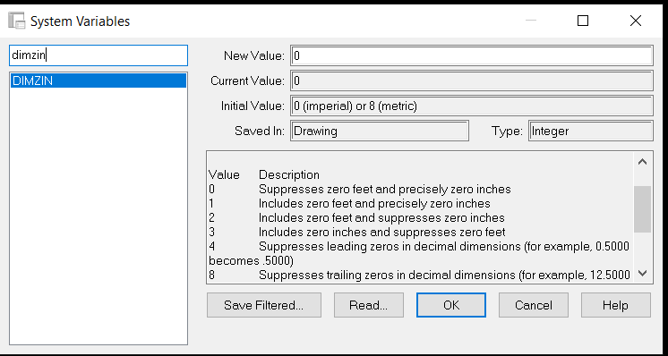

I think you'll need to set dimzin to 1 (Includes zero feet and precisely zero inches) A setting of 0 suppresses 0 feet and the dash.
Yep !  That's it   Thanks !  -David
Thanks Al !  LOL  Older ( much older )  help files only mention that 0-3 pertain to feet and inches.  It gives no explanations.  Add my memory ain't what it was !  -David
