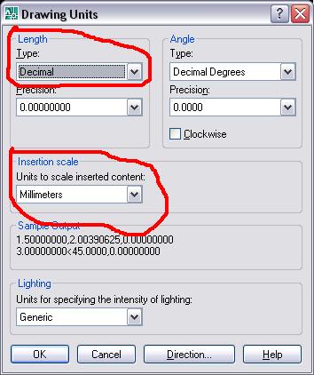

Tiger Posted January 28, 2009 Posted January 28, 2009 what is your Units set as? (Go Format - Units and check under Insertion scale) The scale 1:50 that you said you had, its set on the viewport right? Under the Properties, while having the dim marked, is the tickbox Associative ticked? Quote
sparkyuk Posted January 28, 2009 Author Posted January 28, 2009 what is your Units set as? (Go Format - Units and check under Insertion scale) mm's now was set in inches but hasnt made any difference The scale 1:50 that you said you had, its set on the viewport right? yes it is but im sorry it was 1:100 not 1:50 Under the Properties, while having the dim marked, is the tickbox Associative ticked? yes Quote

Alex_AW Posted January 28, 2009 Posted January 28, 2009 sparkyuk, you may dim the drawing in modelspace in the model tab. In this case you should set the DIMSCALE variable to 100. You may do it in the modelspace coming there through a viewport - DIMSCALE = 0 If you want to do it in the layout so all your dimensions will stay in the paperspace - DIMSCALE=1; DIMASSOC=2. Quote
sparkyuk Posted January 29, 2009 Author Posted January 29, 2009 Thanks guys been playing around and the only way i have managed to get it to be in mm's at the right scale is to alter smp-1 to the setting shown, is this the right way to do it as all the others ways i have tried still come back with cm's not mm's ? Quote
Alex_AW Posted January 29, 2009 Posted January 29, 2009 This way is less convenient - you'll have to make a dimstyle for each scale you use. Moreover it could cause a mistake - you may accidentally use a wrong dimstyle. Quote
