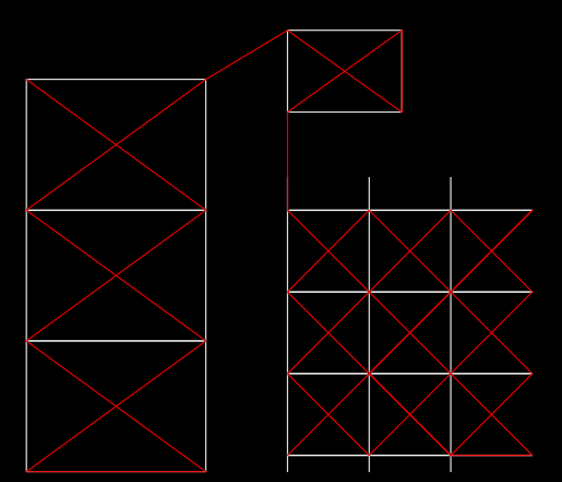

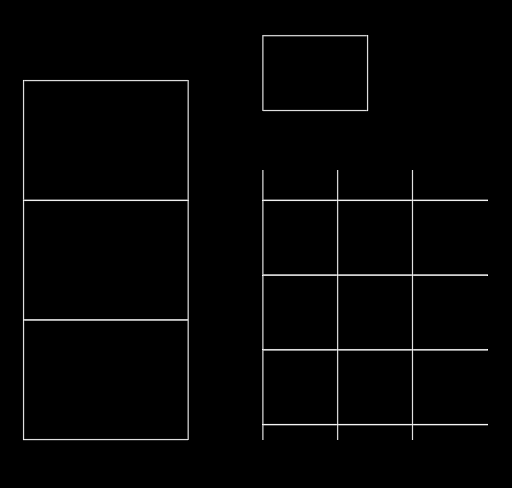

Let's say you want to snap to the center of several rectangles (closed or open or part of a grid) such as the following:

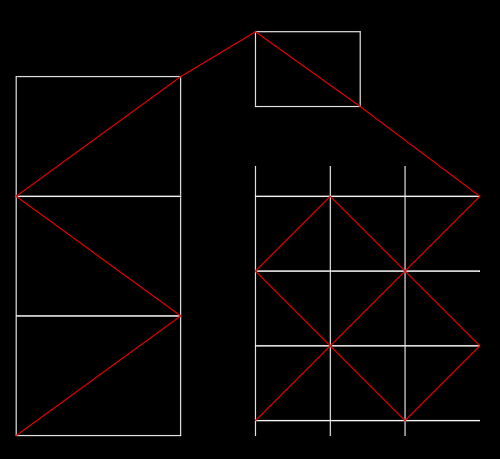

You could create a single polyline  (red) from corner to opposite corner using osnap end and intersection and then use osnap midpoint to snap the block to the centers. The single polyline is then easily deleted.
