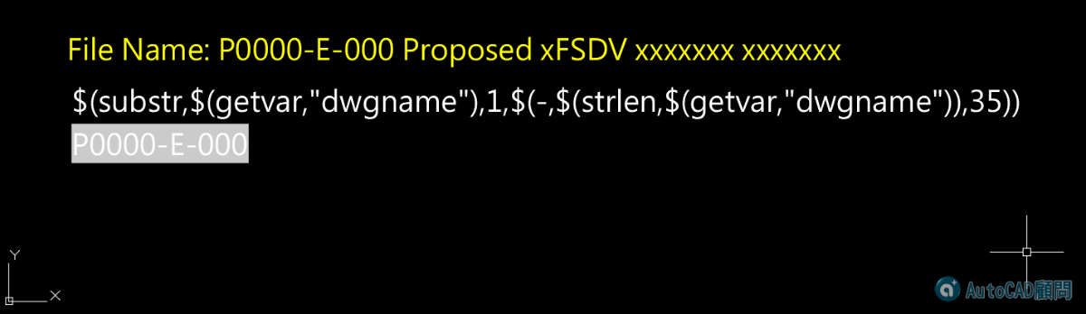

op90o Posted December 10, 2021 Posted December 10, 2021 On 2021/10/8 at PM6點57分, Ciro said: 有人知道如何刪除文件名的前 12 個圖表嗎? 我正在使用該表達式來獲取文件和所有大寫 $(substr,$(getvar,"dwgname"),1,$(-,$(strlen,$(getvar,"dwgname")),4)) \ f "%tc1%fn6">% 文件名:P0000-E-000 提議的 xFSDV xxxxxxx xxxxxxx 我想刪除 P0000-E-000 $(substr,$(getvar,"dwgname"),1,$(-,$(strlen,$(getvar,"dwgname")),35)) Quote
