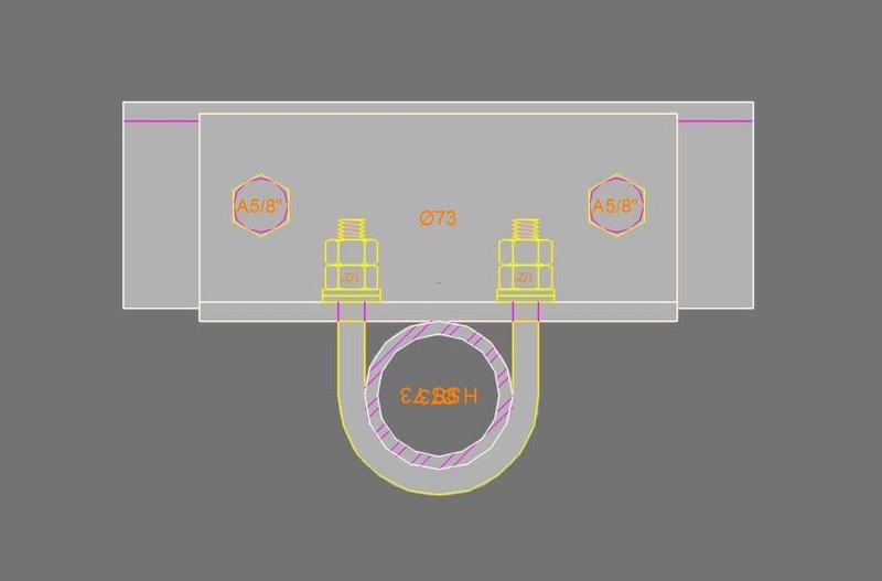

I am trying to change the colour from one to another on blocks and nested blocks. Example: Change object colour (lines and plines and arcs and circles) 2 > 8 and 6 > 8 as well as changing hatch colour 8 > 9. It would be nice for the user to be able to have a selection window to select the blocks. I looked everywhere but cannot seem to find any lisp that cover nested blocks or change colour to another colour. I do not wish to change the object colours to by block or by layer. reminder that I do have other objects (lines etc...)in other colours within the same block that I do not want to change; that is the reason I would like specific object colours to change.
Please help!
Thanks for your reply,
I did look a lot but unsuccessful! most cases change colors all together or to byblock and that is not what I am looking for.
thanks anyways

Good morning Ray,
I have tried the lisp you have sent. Upon repeating the command over different blocks it looks that hatch does not seem to work in some instances. You can see on snapshots I attached. especially in second and third pictures: it seems that your lisp changes the hatch and line colours but as soon as I open the block editor something strange happens; that is hatch changes to its original colour and line colours change to their original colour when I save the block.
Could you please do your magic again and see what the problem is:
in general I would like all colours under blocks and nested blocks for lines/plines/arc/circles 2 > 0 and 6 > 8 and 31 > 8,  and all hatches blocks and nested blocks to be 8 > 9 and 6 > 8.
please help!
the snapshots you see below are after executing your lisp.
image.png.d4b85027a2e5ca54a54e983fe7b4eb00.png #1) after executing your lisp
image.png.164e7b993c8cc26096d8f8a392426f4b.png #2) after I open block editor. It seems to stay that way when I save
The code did not consider dynamic blocks and their anonymous 'offspring'. You have changed the colors a bit. Are you sure about '2 > 0' (0 = ByBlock)?
Anyway here is the new code:

This lisp works great!
Thank you for your hard work and capturing what I was trying to achieve.
Roy! you the man!
