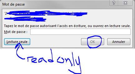

The two excel files are admin password protected so I have to click read only - would this constitute an issue?
Thanks
My first guess would be the password gets in the way. I have made 2 changes but I can't tell if they will work

Good morning rlx,
Still not working! but I thank you for your help and time you spent on this.
I am receiving : "bad argument type: numberp:" nil: and this dialog box on my screen:
I do understand this has been a painful process.
Thanks

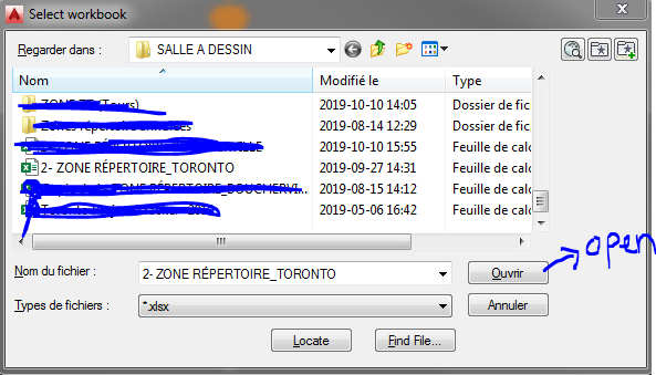

In lisp you either use \\ or / but not \ because a single \ is an escape character. The \ is usually followed by a letter to give it a special meaning like \n for new line or \t for tab etc.
from the help function of AutoCad : (getfiled title default ext flags)
so what's wrong with (setq fn (getfiled "T:\SALLE A DESSIN\2- ZONE RÉPERTOIRE_TORONTO.xlsx" "" "xlsx;xls" 4))?
well :danger::
1) : the \  sould be \\ or /
2) : the 1st parameter of getfiled is a title , not a filename
3) : if you want to select a existing file maybe better use 0 as flag?
so to wrap it up :
(setq fn (getfiled "Select workbook" "T:\\SALLE A DESSIN\\2- ZONE RÉPERTOIRE_TORONTO.xlsx" "xlsx;xls" 0))
or
(setq fn (getfiled "Select workbook" "T:/SALLE A DESSIN/2- ZONE RÉPERTOIRE_TORONTO.xlsx" "xlsx;xls" 0))
or just
(setq fn (getfiled "Select workbook" "T:/SALLE A DESSIN/" "xlsx;xls" 0))
Edited by rlx

Thank you again for looking at this:

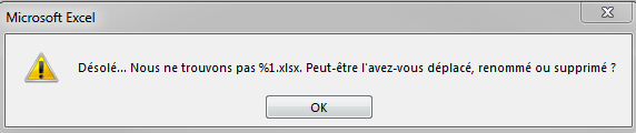

with the correct path, now I am getting inside the correct directory but I have to click open, even though the excel file is selected by default (through your LISP).
the message says: Sorry! We did not find %1.xlsx. Perhapsit it was displaced, renamed or removed? (But if you hit enter it does open the excel file)
By hitting enter key 3 times, I can get it and bypass all these 3 windows - can this be keyed in into the lisp?
Thanks

Sambuddy,
The program is just a generic for opening any excel file in the folder you specify. I always meant it to be an example to get you started - not a out of the box program for you. If you want it to just open a specific file, just replace:
(getfiled "Select an Excel File to Open:" "" "xlsx;xls" 4)
with:
(findfile "T:\\SALLE A DESSIN\\2- ZONE RÉPERTOIRE_TORONTO.xlsx")
Sorry - I have no idea why the "%1.xlsx" is happening to you. I works on all the files I tested. As rlx points out, perhaps it is a password issue.
