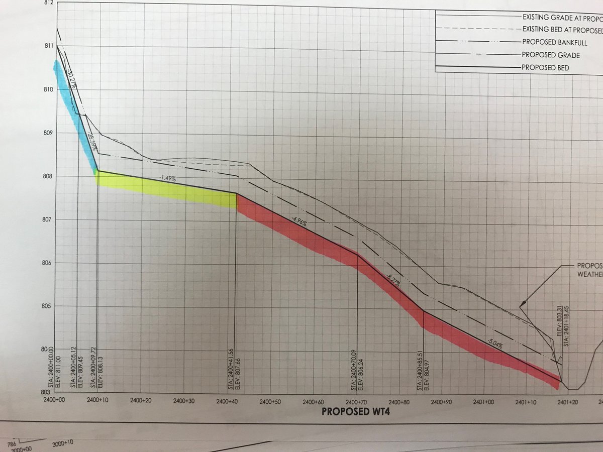

  I am new to writing lisp routines, what I am needing to do is: create hatching that follows below a profile and have the hatching layer conditional dependent on the slope of the profile.
  Essentially what is happening, we have material that needs to be placed but the material size varies depending on the slope. Slope between 0-5% uses finer material, 6-15% a little denser and anything over 15% is a very dense and large material. We need to show the contractors a hatch that runs below the profile and changes hatch pattern depending on what the slope grade is. The two projects we have to do this for are extremely large and manually hatching would take forever.
  I've tried to find/create a lisp to do this, but it gets a little complex for me. Any ideas?
 Thanks :)
 Sorry, here is a picture of what I mean.
So I have a profile and I have slope labels assigned to the profile. Depending on the slope, we use a different consistency material. We want to show that difference by adding hatch (similar to the highlighter below) that changes hatch consistency (or layer) based on conditional slope grades.
So what im trying to do is create a lisp where I can click on the profile and it will automatically add the hatch and change the layer/hatch based off the conditional slope grade.

   Here is a piece of code i found that does sort of what i need. The issues with this are that first, it doesnt allow me to select a profile, only a polyline. Second, id like to add the conditional statements that change the hatch depending on grade of slope. Any ideas?

Using a polyline is faster than picking each section. It would be easy to make a hatch of a fixed shape so ends are vertical, using pline segments.
As no dwg need some answers for some simple questions.
Vertical Depth of hatch.
Most important some suggestion of colors 1-1.9999 blue, 2-2.999 green and so on.
(vl-load-com)

  Here is the lisp I was trying to figure out. Someone in the autodesk forum was able to assist but I wanted to put this here in case anyone ever needs it and so you can see what I meant.
