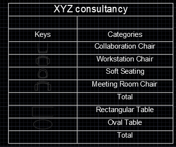

I have to merge multiple tables and need to form the resultant table as shown in the attached DWG.
First two columns for the resultant table must be same and the third column gets added as per taking reference of first two columns.

No code but copy lot1 table and add columns by pick other tables and which column to join in this approach would allow a more universal answer and allow for say 1 2 or 3 column add.
(vla-InsertRows obj2  rownum  (vla-GetRowHeight obj2 (- rownum 1)) 1) should be same for Columns
Had a play then realised going in wrong direction, need suppress heading added. But method is there copy one of the tables use as master, pick the 1st value in left column 3rd row down keep repeating.

Had another go start with this have to go know no time. Delete columns as code adds.
