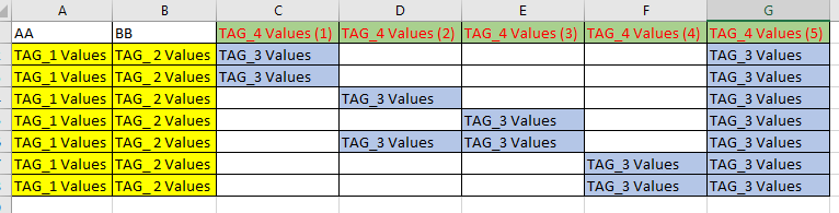

Hello Lisp guru's,
I need a lisp to extract attributes from autocad block to excel in a specific format.
In my drawing I have a few blocks which are having four attribute tags named as TAG_1, TAG_2, TAG_3 & TAG_4
from each block TAG_1 values should be pasted in column 1 (A) staring from 2nd row, Tag_2 values should be pasted in Column 2 (B).
and Tag_4 Should be pasted in 1st Row (CC). All the Tag_4 values are numerical so the values should be starting from 1, 2 , 3 , 4 etc.
Tag_3 values should be populate based on the Tag_4 value.
Please find the below picture for reference.
Tag_1 & Tag_2 values are alpha numeric values. and Tag_3 values are numeric only.
Please help me out as I have researched alot in so many forums but I couldn't get any idea to make the script.

The rows that start with a yellow cell have 2 or 3 TAG_3 values. Can you explain that?
Hi Roy, thanks for responding my query. Here I have attached the sample drawing containing with the blocks to extract.
Also attached the snip of required output of the attribute values in excel.
Tag_3 values are depends on number of blocks in my design and also Tag_3 value should represent the quantity of Tag_4.
Sorry for my bad english.
Drawing check.dwg

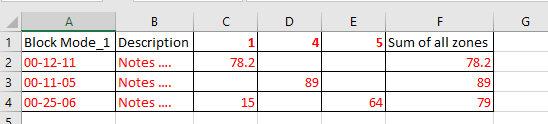

A bit harder than I thought:

Hi Roy, I am getting the following error when testing the lisp.
; error: bad function: #<SUBR @000001cb22b41bb0 -lambda->
I am unable to understand the error to fix it from my end. I  am greatly appreciated  your efforts for writing the script as I have approached some other forums as well but didn't get luck from any members. Please help me out to solve the issue. Thanks in advance
43 minutes ago, savinirsb4u said:
I am unable to understand the error to fix it from my end.......
Just add a QUOTE before the lambda function as follows:

Hi thank you very much guys.
Lisp is perfectly working for me. I am very curious about this lisp and willing to learn more on scripting.
If possible can you do one more favour for me if possible.
I have 3 more additional requests with this script.
1) Need to select all the blocks with block name "Block Mode_1" without selecting manually.
2) Instead of choosing the CSV path can we get the excel in the same drawing file path with drawing name
3) Really sorry for this 3rd question. Can we remove TAG_2 details from selection set. (No need to export Tag_2 Values into excel)

Hi Roy,
Thank you very much for the revised code.
I have modified some part from the script as below to get the correct headers position:
(append '("\"Block Mode_1\"") '("\"Sum of all zones\"") (mapcar 'itoa intHeaderLst) )
One more final request in this tread.
Can I get a new lisp to get results in the below format(Only 2 columns required):
Revised code below. The command functions are called SpecialExtractWithDetails and SpecialExtractNoDetails.
