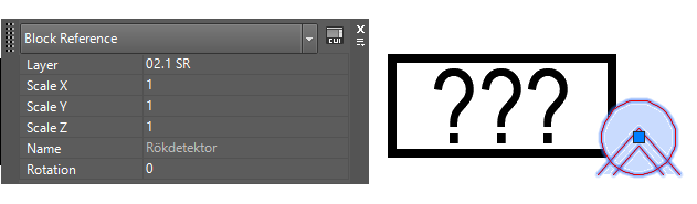

I have a bunch of (50 or so) blocks that are on scale 1 in a specific size to fit a template in viewport scale 1:100. And if I scale the blocks to 2.5 they then fit viewport scale 1:250 etc etc.
But now I have to resize the blocks to make them a bit smaller, or rather the contents in the blocks to be smaller - perhaps 0.7x. So I'd like the contents in "default" scale 1 to be smaller.
Is there some smart way in going about this or I have to edit each block and resize the content one by one?

Attached image. I have 50 or so similar blocks like the one in the image. They all sit in the corner of this rectangle. The rectangle is a separate block.
As per the image the scale of the block is 1. I would want to change all the 50 or so similar blocks to a smaller size - but with the scale still at 1. So I don't want to change the blocks', let's say default, scale at 1. I just want to resize the content.
The reason being that it's easier for our multiple users of these files to scale them logically. (1:100 = 1; 1:150 = 1.5; 1:200 = 2 etc etc)
If you edit the block, the scale will still be 1.

Yes I know,  my question is if there is a way to do this with multiple blocks at the same time.
Where are the main copies of these blocks located (how are they inserted)?
Are all blocks to be scaled the same?
I would agree in making these blocks annotative, then no need to worry about the scale remaining 1, they will show up correctly in each viewport scale.
If you still want to go about it the requested method, then you need to ask this question in the LISP Forum.
